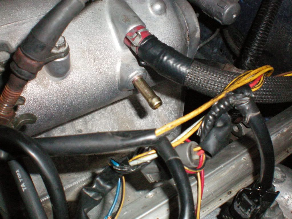

This is the one right behind the valve cover

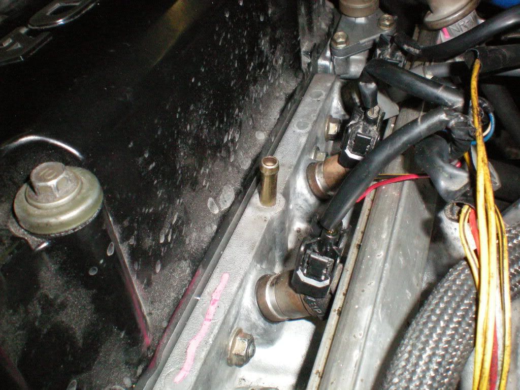

and this is the one on the plenum

Just put 2 caps on those 2 open vac lines. They are for things that your OBD1 car does not have.
