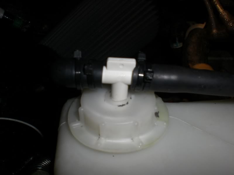

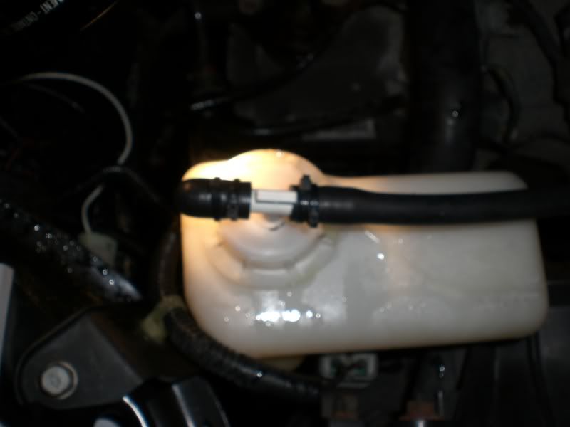

Appearantly this is very common on these cars. I have done and still am doing some research about this . I just figured i would post this up if someone could help. Well at first my car just had idle surge. Then my heater would only blow cold air until the temperature reading on my gauge went all the way up to hot then it would blow hot air and the temperature would drop. (I thought this was a sticking thermostat) Then the temperature would go all the way up to the H on the gauge and drop no matter what the heater blew(hot or cold). The after a 40 mile ride i shut the car off for about 5 minutes then when i started it the motor was idling poorly and wanted to stall, thats when i seen a lot of white smoke pouring out the exhaust. I reved it a couple of times and there was a lot of white smoke that came out the exhaust( i thought it was a head gasket) but the smoke cleared up and it idled fine. I checked for any leaks and there were none. I replaced the thermostat and filled up the coolant system. I took the car for a 10 minute ride down the highway and the gauge read normal. When i got home i let the car idle for a couple minutes while i went in my house for literally a minute. When i came out there was coolant all over the engine and the car was idling poorly again with white smoke pouring out the exhaust. I reved it and the smoke cleared but the motor just kept idle surging. The coolant wasnt dirty and it has a new thermostat. It also seemed like the lower radiator hose was cold which means that the thermostat never opened? Also the upper radiator hose seemed like it was swollen to the point where it looked like it was gonna burst. I also read that the little plastic L piece on top of the coolant expansion tank cap has a spring in it, is that true? Mine broke along time ago and i have vaccum t fitting in its place with the other end capped off. Any info would really help. Thanks and sorry for the long long post.
Did you happen to check your thermostat rating? sometimes they put a high rating on them and that is why they dont open most of the time and thats why i always try and find the lowest possible.....anyhow that could be one reason why it did not open another well lets just say thermostats arent the most reliable things in a car they can go bad very easily or last for a long time its hit or miss and quality counts as well.....
but the reason your upper hose looked like it was about to burst was probaly the heated coolant and gasses expanding or you may have installed your thermostat the wrong way really it sounds to me that if your thermostat was replaced id double check to make sure it was done correctly and then see what happens
and you really should not block anything off if i am reading right you blocked off the hose that connects to the overflow res? thats the only one i can think of that comes off the radiator.
