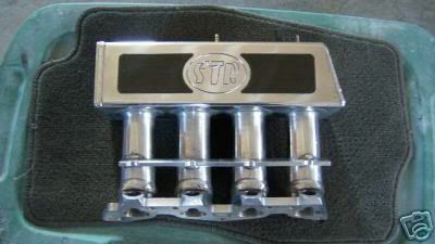

#48555 ok simple which one u think would be better for my build
a stock d16z6 intake manifold or this ? OH and my engine setup is
bored a6 block
pnpolished and valve job d16z6 HEAD VTEC skunk springs+cam and retanors and seals all skunk
eagle rods+pistons+nhe rings chrome d ,block guard and few other but which IM ? thanks guys and gals

#48578 that str one looks good. i'd try it out, i've heard the y8 i think it is flows better than the z6 tho

#48689 I'm not familiar with the brand but if I were looking at an intake manifold, I would ask myself, how much R&D did the company put into it? Do they have the equipment and know-how to even tune the manifold properly? Did they take into account plenum shape, volume, throttle body position, runner/plenum intersect, runner length/cross-section, and flange angle? Is this manifold built for N/A or FI? Chances are my shiny new manifold isn't going to distribute air to each cylinder evenly. Unfortunately the stock ECU decides fuel injector pulse width evenly for each cylinder based on an O2 sensor that combines exhaust from all cylinders, so it's going to run some cylinders lean, and some rich, which is eventually going to burn down my motor. Also, you're going to lose the sound wave tuning that's built into the stock manifold to give you a slight boost over atmospheric pressure at the mid RPMs.
Tuning intake manifolds is a science. I wouldn't put some ebay start up company's product on my car.
You're more likely to do more harm than good when changing the intake manifold and/or throttle body. With FI, it's not so critical, because you're shoving air in and not relying on tuning to suck the air in. It's much more complicated than exhaust manifold tuning where the air is being pushed out and you just want to line up the vacuum pulses between each cylinder to scavenge as much air into the combustion chamber as possible at a particular RPM.

ok so what ur saying in just port the d16z6 IM and throtterl body and ill be good to go right ? im running the d16z6 i was just wondering if this would mek it better? i have the Z6 IM with the throtel body shines and ported up ,and it seems good i just saw this on ebay and thought if it be better ? ok ill keeep it stokc as im happy with it for now, thanks

#48812 STR is a good reliable company
they do alot of American Muscle
but i wouldnt doubt them for a second :thumb:

You found this one on ebay right?? What happened to it? I was watching it and it still had a few days till the acution ended, and now its just gone?? wtf

#48976 I have a Golden Eagle one lol, so i dont need the STR, i was just curious as too how much it would've sold for. The cheapest one i could find the other day was used and the guy still wanted 500 bucks.

flyinryan122 wrote:He is doing an N/A build?
Cause this manifold was strictly made for boost.
as far as I know. but maybe he decided he wanted real power from his D instead :twisted: They all come to the dark side eventually!
