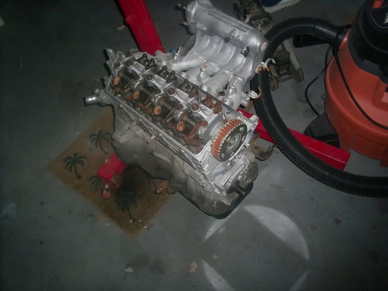

the motor

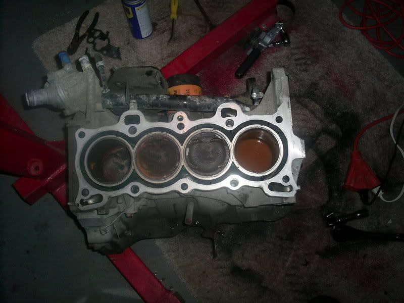

pulled the head off, yeah thats water in side, the motor sat outside with no cover

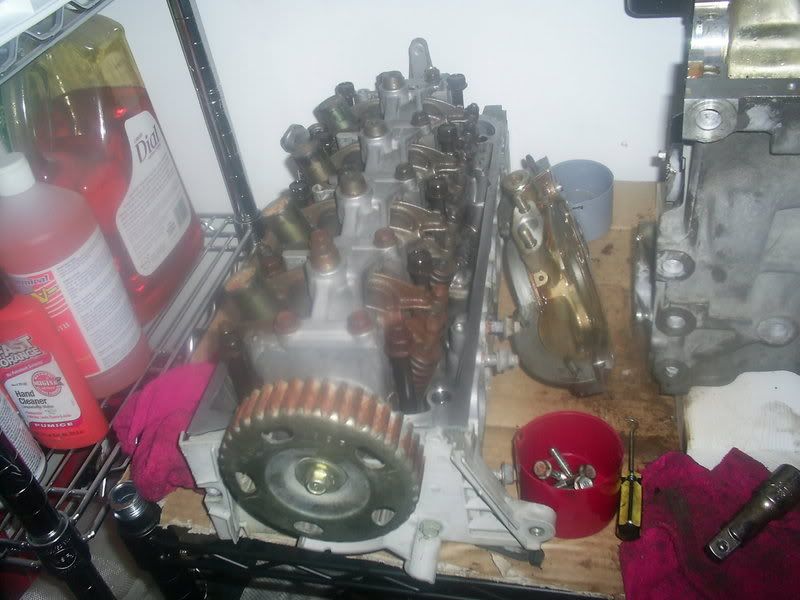

the head off, dosnt look to bad

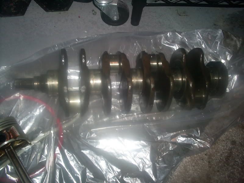

the crank is pretty clean
but the rods arent, pistons seem fine tho
no scratches seems good
