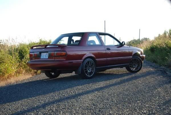

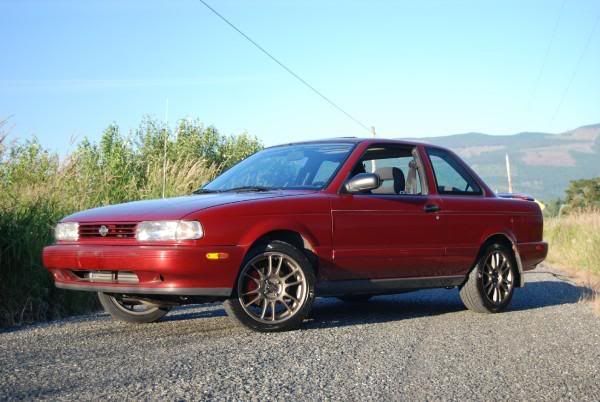

So I forgot who wanted to see it but here it is, pics of my 92 B13 Sentra SE-R with a GTiR swap, and for those of you that dont know nissan at all, a GTiR is a Pulsar GTiR and is a 2L turbo AWD nissan hatch only from japan.
motor specs, SR20DE-T GTiR, GT28R single BB stock turbo, closed deck, bigger water pump than other SRs, bigger oil pump, dual oil squarters that hit the bottom of the pistons to help keep them cooler, bigger cam, ITBs (individual throttle bodys).
I don't have any good under the hood pics so I will try to get some up sometime soon.
