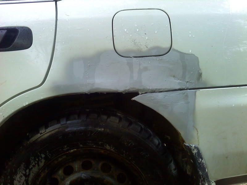

#182767 started fixing my rust yesterday

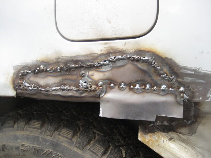

iv been learning how to weld only done it twice and then i started working on my body
so heads up that my welding is horrible and no need to say how much i suck at it i know lol sheet medal is not very forgiving :x
started on the passenger side and alomst done just a few more panles to weld on and then grinding and bondo
here are some pics and tips for welding are greatly apriciated :thumb: :thumb:

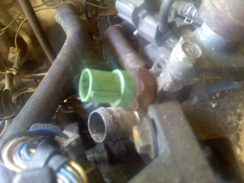

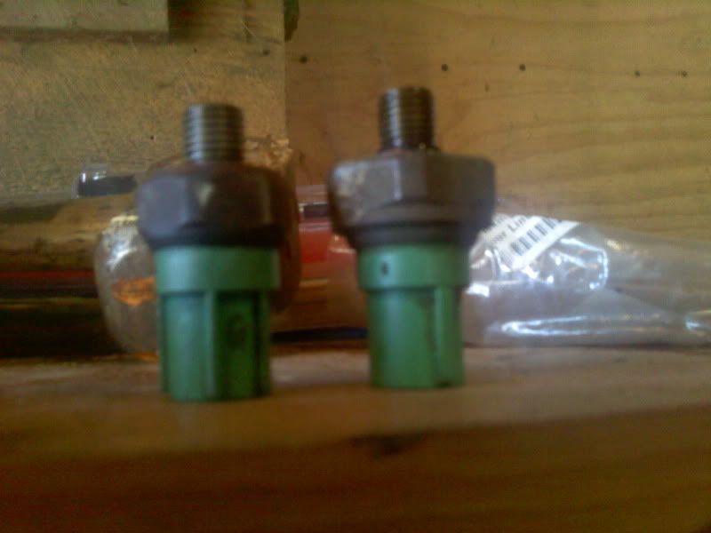

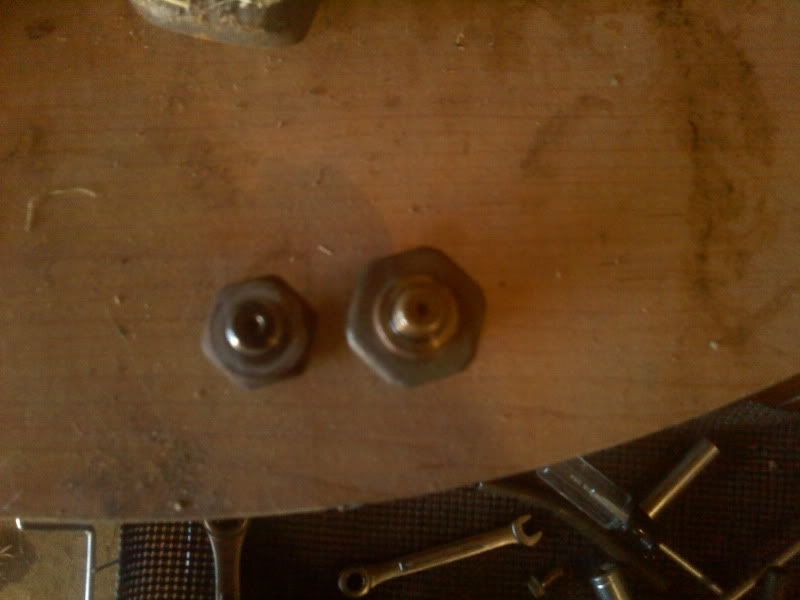

ohh also found out that a power steering pressure sensor will double as a vtec oil prssure sensor :thumb:
not sure if it work as i havnt wired vtec but it fits lol

#191532 heres a few rust repair pics
looks awfull but its solid and no more rust :thumb:
just did rear shoes and finally wired vtec
wired the power streering pressure switch for vtec and it works good seems to kicks a bit high like around 6k but i like having vtec

#191598 I think you should finish the rust repair job right :thumb:
looks like you grinded the welds down for the most part, primered, and now the car is outside again.
Primer absorbs water which means you or new metal & welds will start to rust. I would finish grinding it smooth, finish smoothing with filler, prime and then paint. Even if the paint is a rattle can and not a perfect match, it will seal the surface.
Don't forget about the backside of the metal as well :thumb:
By eg84dr
#191622 i didnt know primer absorbes water
good to know
the inside/backside of the metal is sealed with rubber undercoating
i filled in the body a little bit just with some bondo i will paint it asap now that i know primer absorbes water
thanks teal
after i paint it thats it foe body work iu really dont care how it looks im all for a shitty looking car with nice tires and amazing handeling

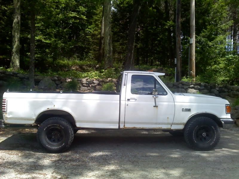

heres the best part
all i ahve to say is go ahead hate on it haha
but it was only 400 and ait runs and drives and has the stright 6 in it with less then 30k on a rebuild
should do me pretty good for the winter
FOUND ON ROAD DEAD!

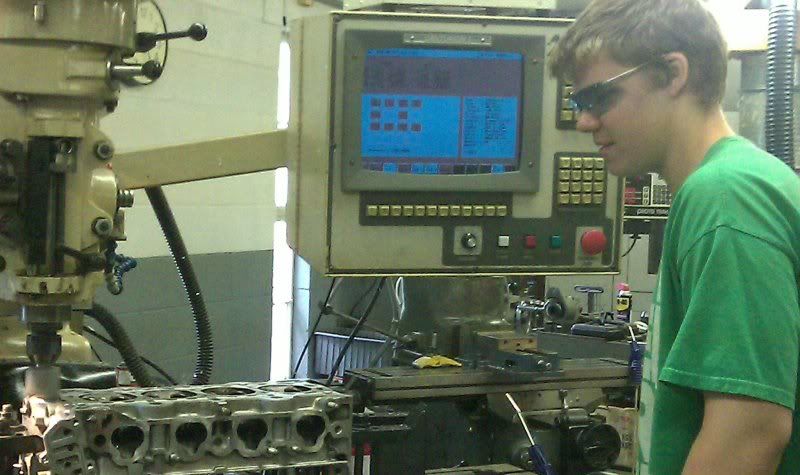

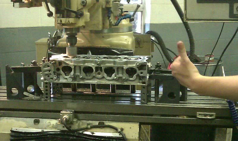

#200892 updates!

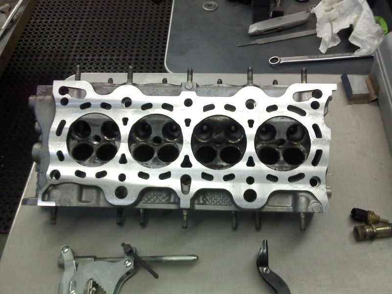

got my new head resurfaced/shaved today
it was sligtly warped to begin with
it was off .002 from end to end wich is really really small haha
never the less we took .008 off
went very well super easy once you have the head level
here are a few pics
will be relapping the valves tomrow will update with pics
setup clamps and shit
one of the cuts i took on it
all done last pass in the middle :thumb:
all done and pretty
