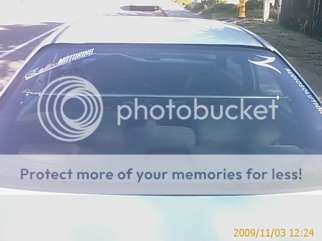

c-piller bar

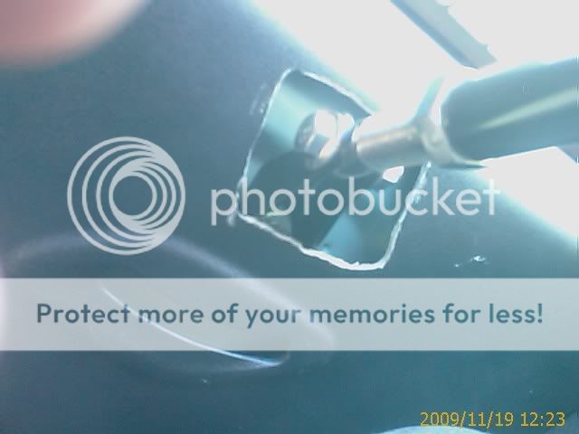

can u take pics of the points where c-pillar bar is mounted?
- Thu Nov 19, 2009 8:29 pm
#157359
got ya coverd
it goes right were your rear seatbelt shit goes. ther is 1 big bolt. it goes there. i had to add a metal spacer cause the bar had to be fully extended to work. thus it was only on like the last 2 threds. so i spaced it half inch on each side and now its fine. supper stiff and i can notice the diff in it when turning and i feel less chassis twist.
