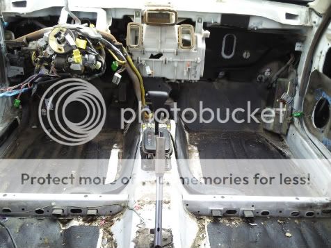

#194871 Here's some pics of what Ive done. cleaned the motor an now im cleaning the interior so i can put it all back in.

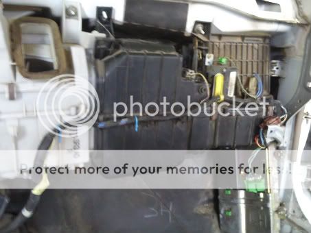

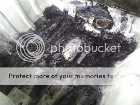

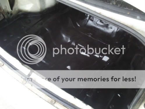

#195215 alright well this is what i did today. The final coat is the truck bed coating. it has the nice rough surface to it. :thumb: Then i took the ac unit from my ej an put i in.
I also got the dash an carpet back in. Tomorrow ill be cleaning an putting all the interior back in. Then ill be starting to clean the transmission. Also im hoping to get my engine off tomorrow to get it honed an the new rings put in. :woot:

eg84dr wrote:what kind of truck bed liner did you use and what did you do to prep it before putting the bed liner on ?
The first two steps were dupli-color rust fix, it turn the leftover rust to a hard primer while stopping rust. then the second is also from dupli-color an its the self-etching primer. The third is the truck bed coating.
The bed coating i got at wal-mart for about 6$ Its the one in the spray-able can.
An the other cans ran about 6$ each from O'reilly auto parts.
The bed coating stuff impressed me on how it came out. :thumb:

berg89 wrote:Image
That looks really nice. I need to do mine.

eg84dr wrote:so you didnt sand or anything just cleaned the hell out of it and primed it?
it looks killer :thumb: :thumb:
I took a wire wheel on a drill an got as much off as i could. I vacuumed all the chunks up, then i took an wet towel an wiped it down then let it dry. Then from there i started the painting process. The bed coating dried a flat color. It looks better now since i got the trunk carpet on.
