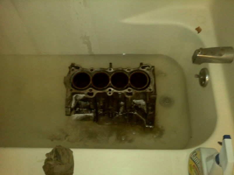

#170667 started cleaning the z6 block

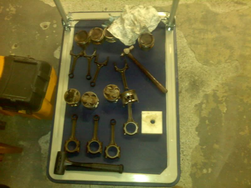

i have decided to use my old b7 pistons and get rings for them instead of getting p29's
tomrow ill finish cleaning the block and start tearing down the b7 block and hopefully get my pm3's on my z6 rods on monday

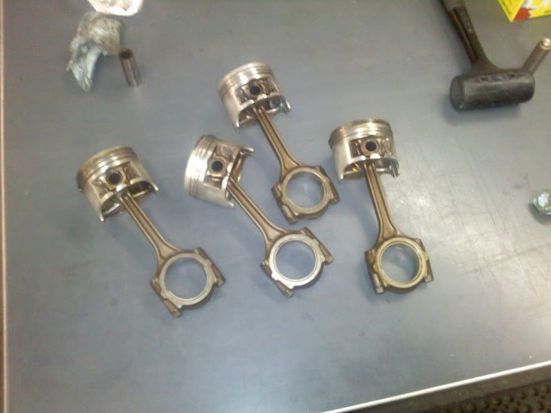

#170669 also heres my thoughts for my high cr build
z6 bottom end with pm3's lightened flywheel and nice stage 2 clutch
mild port and polished d15b jdm head regrind valves
picked up a nice aem intake for 30 bucks in mint condition at the local junk yard
dont know what header to get yet probably just an egay one
and im reading how to tune almost everynight
:thumb:
any sugestions comments greatly apreciated
