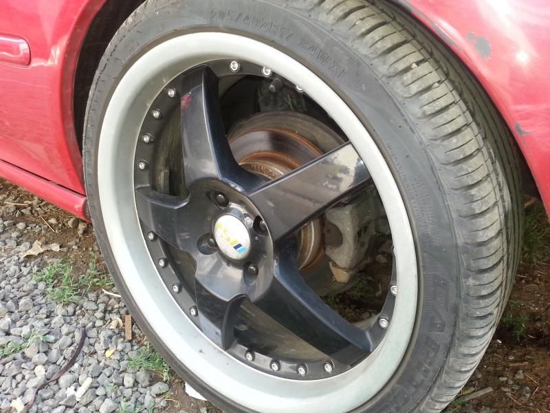

Installed the rear discs from the Integra on the Civic
As well as the adjustable coil overs from the Integra. This is how she sits now.
I know it doesn't look much different, but it does to me. It sure does feel a lot different.

#333632 Looks like a good start :thumb: I like your motor swap plans. My only suggestion, step down a size or two on the wheels.
