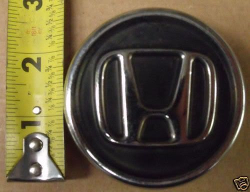

now the real dilemma im facing... I could do the soda can center caps but I really really REALLY want to use the chrome Honda caps i have on my 13s
buuuut the hub bore is too large for them... :x
so i am thinking... i have like 4 sets of 13 inch steelies laying around... cut the centers out of them, put them over the hub center on my car, bolt the wheels overtop of them, mark the hub part of the cut piece with the circle thats the exact size of the center hole in the wheels, cut the piece to that exact size, then weld it in the center of the wheels. then they will be able to use the awesome center caps but more importantly, they will be hubcentric aswell.

TrailerTrash wrote:now the real dilemma im facing... I could do the soda can center caps but I really really REALLY want to use the chrome Honda caps i have on my 13s
have you thought about trying early crv center caps? civic center bore is 56.1 and crv is i believe 64.1 :? might be worth a shot

92civic_vx wrote:have you thought about trying early crv center caps? civic center bore is 56.1 and crv is i believe 64.1 :? might be worth a shot
this is true. you could also take a look at the center caps off of some of the older accords and preludes that had the 4x114.3 bolt pattern, since they have the 64.1 hub bore too.

#309475 i have a set of those center caps that didn't fit my 14's they was bit too big
if u want i can measure them snap some pics for u & u can decide. just PM me since i hardly come around here.

#309519 pretty crappy pic but here is the holes actual size. i dont know how to measure with millimeters :lol:
By bks84
#309572 you take the measurement in inches and multiply by 25.4. assuming thats 2-5/8"
2.625 x 25.4 = 66.675mm

bks84 wrote:you take the measurement in inches and multiply by 25.4. assuming thats 2-5/8"
hmm fancy :thumb:
a few millimeters of a gap is a heck of alot less than half an inch
