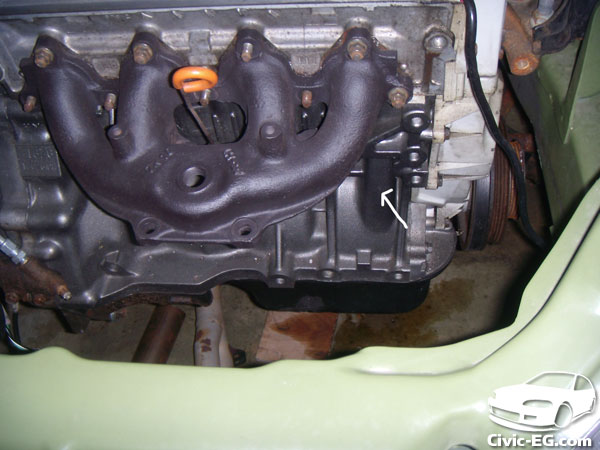

I bought a turbo off a guy with an HX in early 2006 and pieced together the rest of the kit over time.
This is how I bought the kit, and how I assumed he had it on his car.
Finally getting around to installing (I'm busy) it and was test fitting everything yesterday.
I have a HF manifold, adaptor plate, T3 turbo (internal WG) and Spoolin Performance 2.5" DP

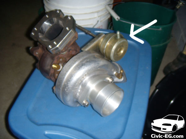

I tried to put the turbo on and the actuator on the back of the turbo hits the block - not even close to being able to fit.
arrows point to the contact areas
Clocking the turbo does me no good. Even if I install the adaptor plate around the other way, I can't flip the turbo around and have the hot side on the driver side because then the 2.5" DP won't work (I love the DP, will do whatever it takes to use it)
Plus the turbo will be hitting the block then.
So it looks like my option is to find another manifold that pushes the turbo farther away from the block. Or convert to external wastegate which means buying a different manifold + wastegate + making a dump tube.
GD Money pit!
Seriously though, I hear of people running T3's and HF manifolds all the time on D series and never heard about this problem happening. Am I missing something?
