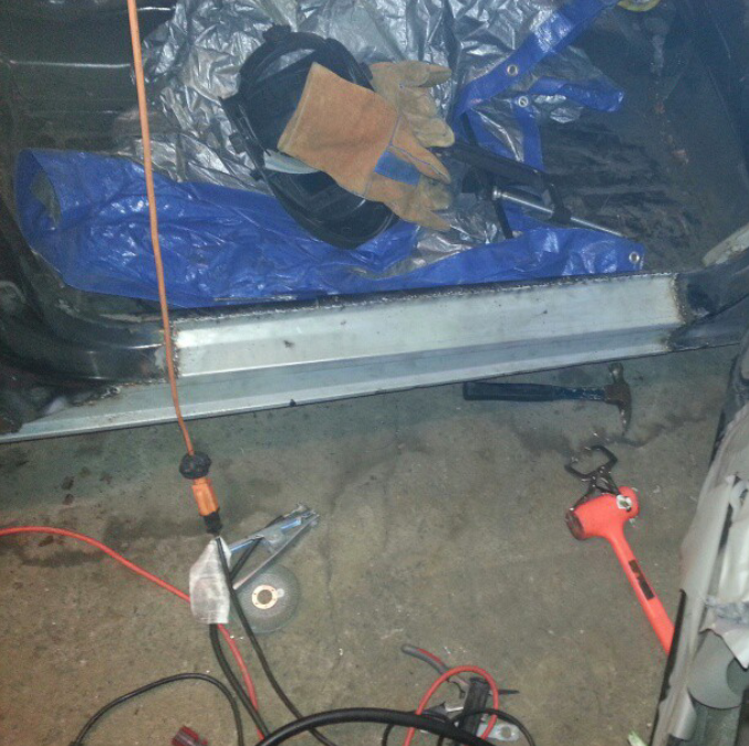

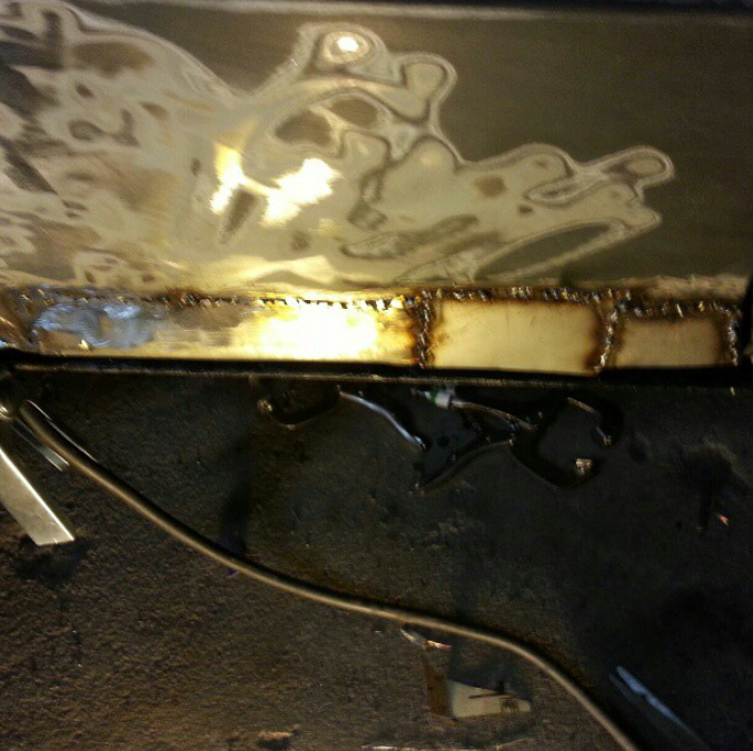

I cut out the rocker panel and welded in a fresh rocker panel. I did this on both sides.

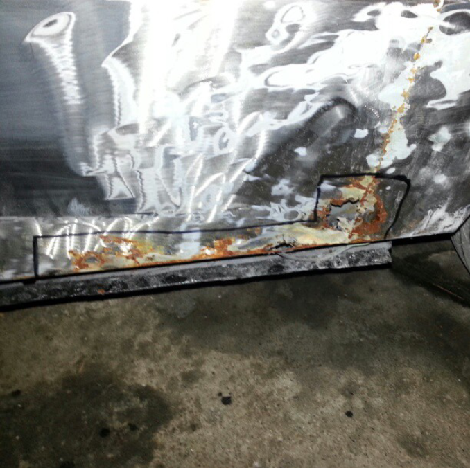

I also had a bunch of rust, on both sides, next to the bottom of the door, right above the rocker panels. I cut these out and welded in some sheet metal.

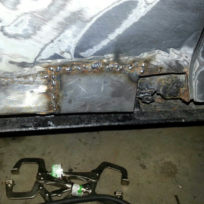

I learned a lot whil doing this. I really never welded anything before this. I practice a little before I started this project, but was pretty much learning as I was going. I pretty much just kept on spot welding until their were no gaps. Then I grinded the welds down.
This is the drivers side after I welder them together. I did it in pieces so the sheet metal would fit better were i cut.

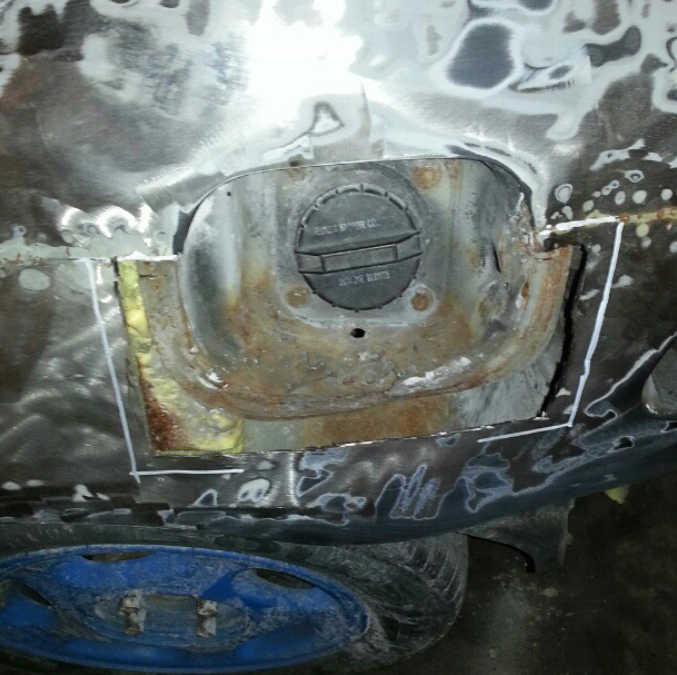

The biggest challenge was trying to figure out how to fix this gap. And...
This. It was completely rotted through.
I decided to just cut around it and weld in a new piece of sheet metal. (Say hello to MORE spray foam :x )

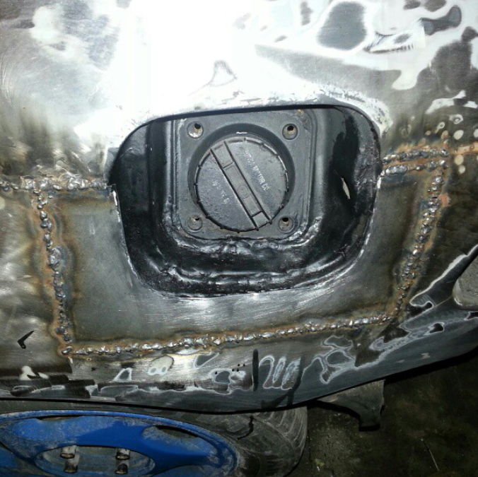

On the inside, I carefully cut out as much of the rust as I could, and grinded out the rest. I then welded in a few small pieces of sheet metal. This was pretty tricky and very scary. Luckily I had almost no gas in my car. (Im actually so low my car wont start) I then put some Rust Encapsulator over it to help prevent it from rust again.

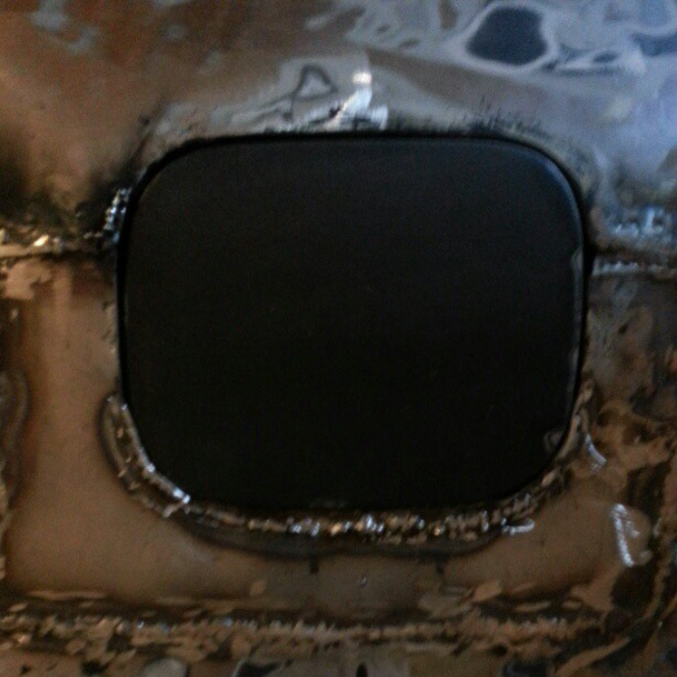

This is how the gas door fits around the new panel. I know none of this is perfect, but it works. And this is my first time welding, so I am pretty proud of myself haha.
And this is what the gas door looks now. Being painted an all. And yes, I know my garage is a mess.

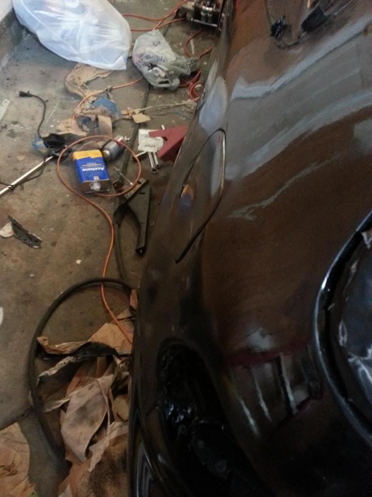

#326054 Got some more pictures. It's not completely back together but I had to fix my gfs eks exhaust.
