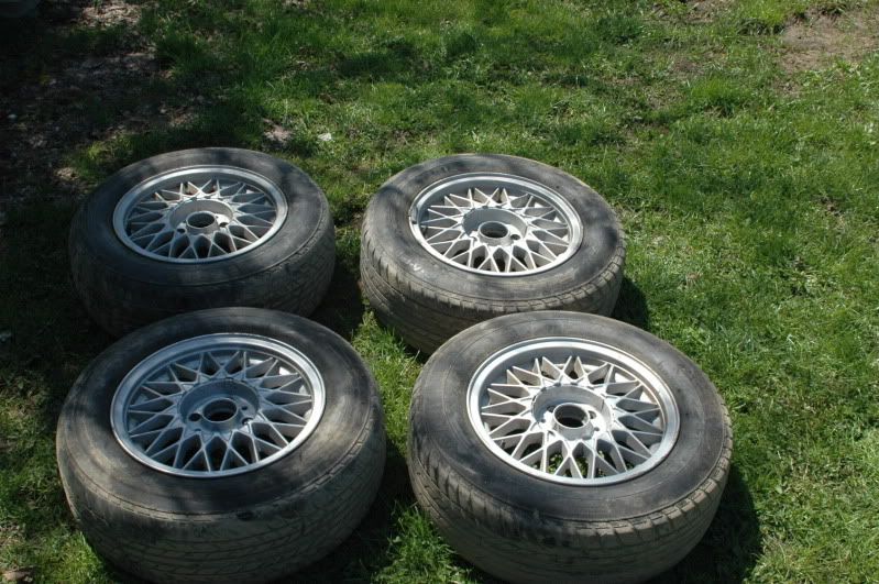

and just bought these BMW 14" rims from a BMW e30 been wanting something like this for awhile now so woot!....

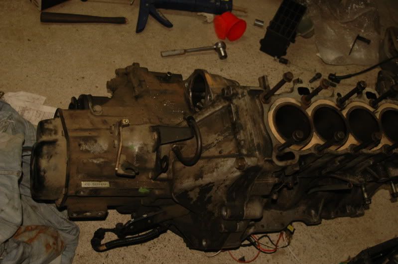

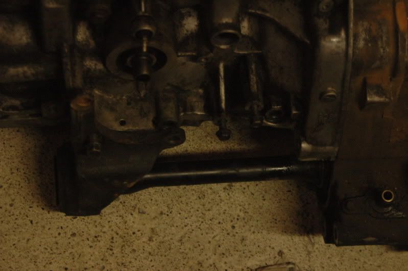

#198710 So a new update after talking to flyingryan well i decided to get myself a cg trans one because it can handle alot and two it in the numbers, and description seems like the best d series trans honda ever made so low and behold half an hour later and a bit lighter in the wallet i pulled a cg trans outa my junkyard mind you it dose have 200 miles so i do plan on going thru it but hey its a cg i have 30days if its really bad to return it and get another one if theres another in there
so anyhow I have a new plan for my car it may take a month or so to do but thats because i want it done right and im slowly getting parts needed etc....
Motor wise i mentioned dohc zc but numbers (money) dont seem to add up i gotta look at it in depth because if im paying 700 for a dohc zc to swap it in correctly (myself of coarse) and all i need is 700 to put into a motor i already have or a bit more i think itd be more beneficial to go ahead and do it that way but yea more on that later now pics of the cg trans and my initial look at it....

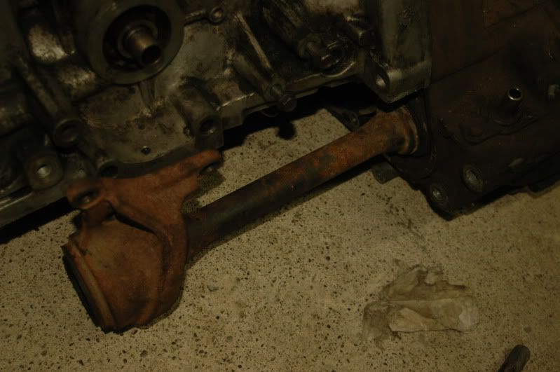

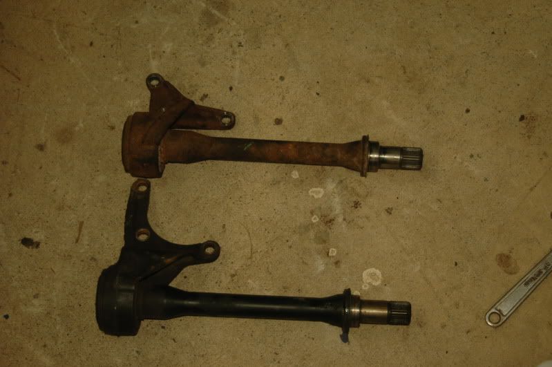

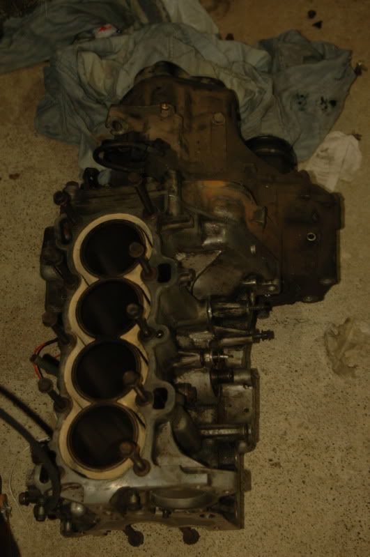

pics below are of a z6 block i have sitting around and the cg trans just test fitting the intermediate shafts i got one that bolted perfectly to the back of teh block from a awd wagon ef and of coarse as youll see in the pics it dosent do to well when inserted into the trans....but thankfully i have the cg intermediate shaft some mods needed but no big deal itll get done right.....
so without further ado pics
Cg has one bolt that works in the back so some customizing will be needed
Above the awd ef intermediate the diff area is too low for it to work properly so it wont even bolt up i mean if it was just a bit longer in the mounting area it might work but nada so cg intermediate it is....

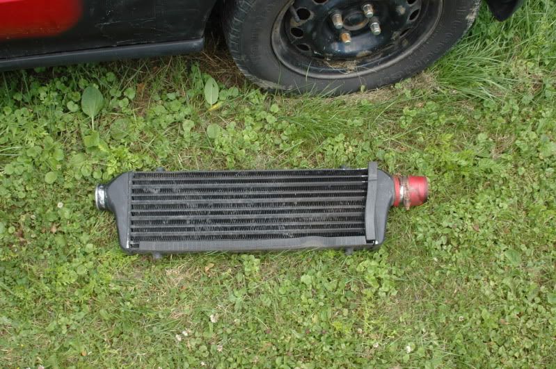

as well as i also traded my shitty skunk 2 intake for a t3/t4 turbo external wastegate some money and another braided line.....so yea may not have made out but i traded a z6 head for it so i guess i still have a even trade going ....

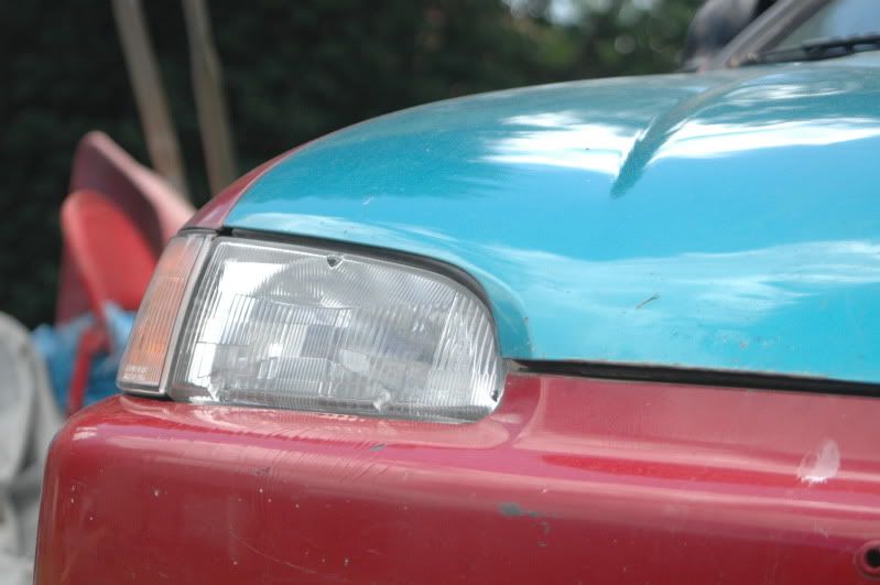

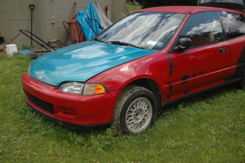

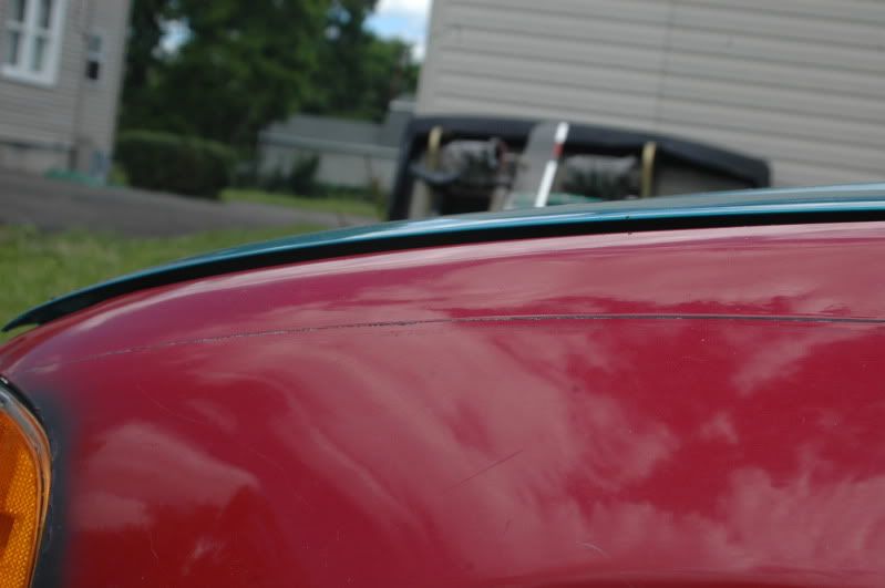

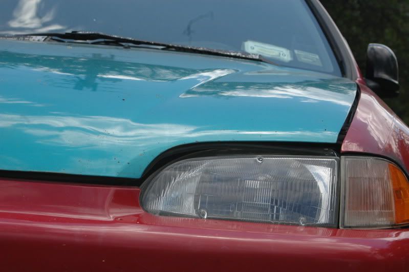

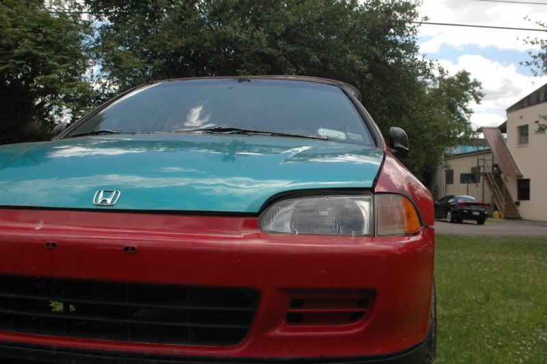

anyhow got some turbo stuff and some pics of the rim on my car.... i cant wait to get working on my car woot!!! also gotta figure out a large problem i have a rather uncool gap its been this way ever since i got rid of my fiberglass hood ive tried two different hoods same gap so im thinking its something with the hinge latch or body tho i dont understand how......anyhow here beith the pics
Every time i look at that rim on my car it renews my faith in this project......
Turbo stuff

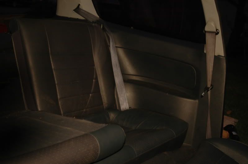

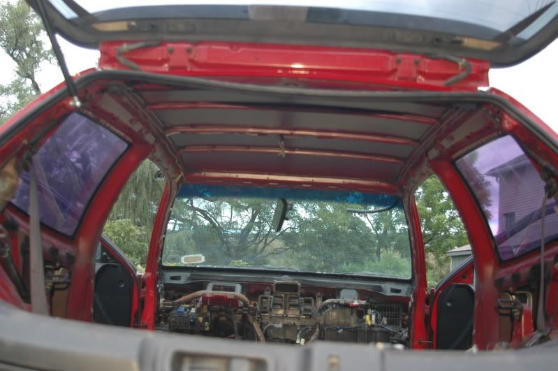

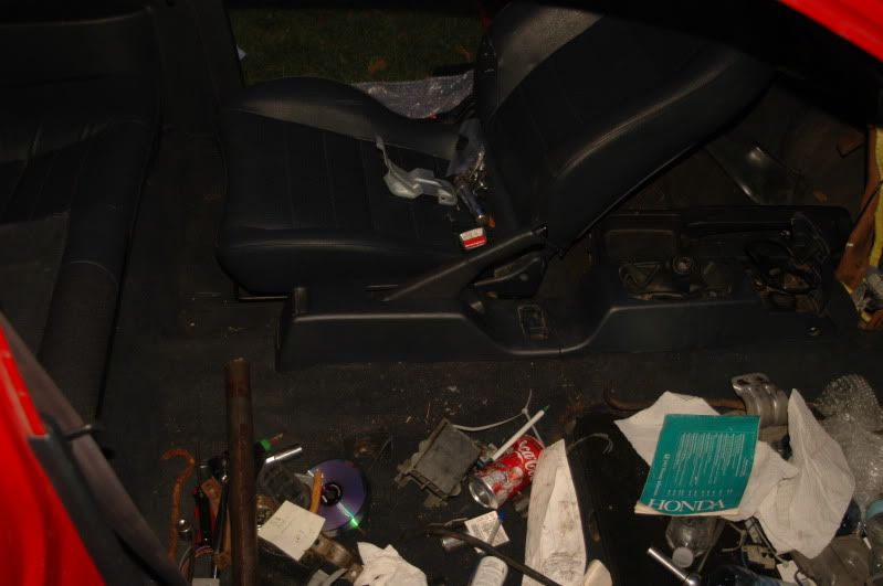

#213078 So its been awhile since i have updated this thread and for good reason its mainly half my car as my good friend is going to buy it however im fixing it up taking what i need from it putting it together so he has a decent car to drive here and there for his family etc.....anyhow got some updates on my black to blue interior...started with it pretty much stripped....
and 3 hours later and a oil change on my buddies ek
