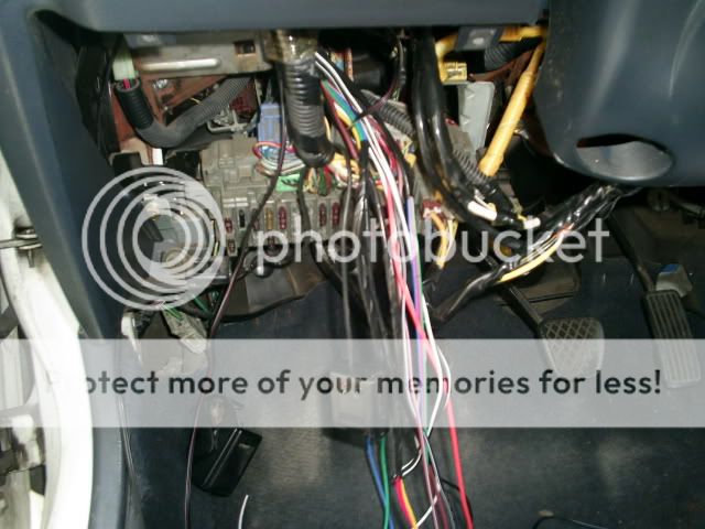

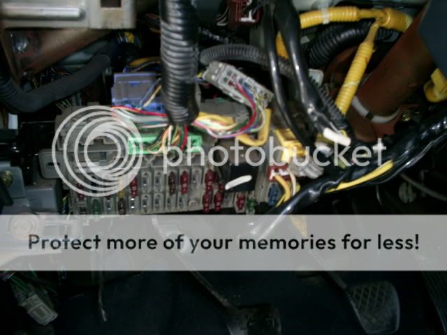

2.step,remove two size 10bolts, and remove the metal piece.
step.3 find the wires ur going to be using. make sure u do some research on wire color of ur car. this is my list....#1.constant=white(+)..#2.starter=black/white(+)..#3.ignition=black/yellow(+)..#4.parking ligths=red/black(+)..#5.trunk=green(-)..#6.doors pins=green/red(-)..#7.horn=blue/red(-)..#8.domeligth=green/red(-).

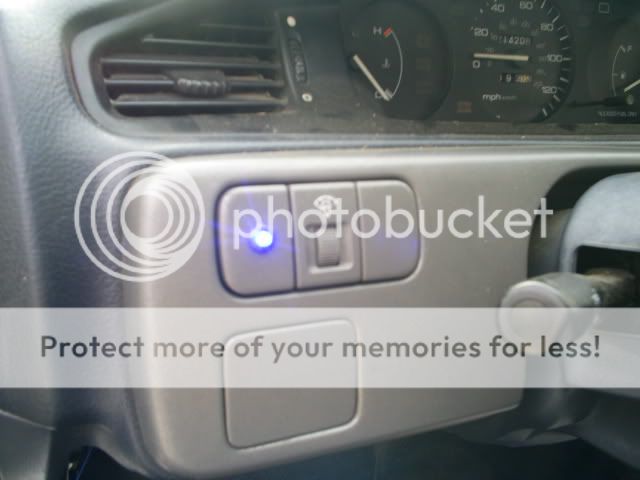

4. after i got the location of all the wires i was going to be using..i install the LED, make sure u drill a hole for ur led in a place or part that u can
easily replace.

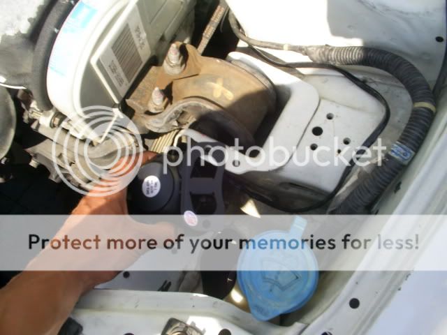

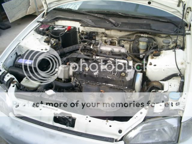

im installing the siren since i dont like to drill hole on my car i use an xcinting hole.

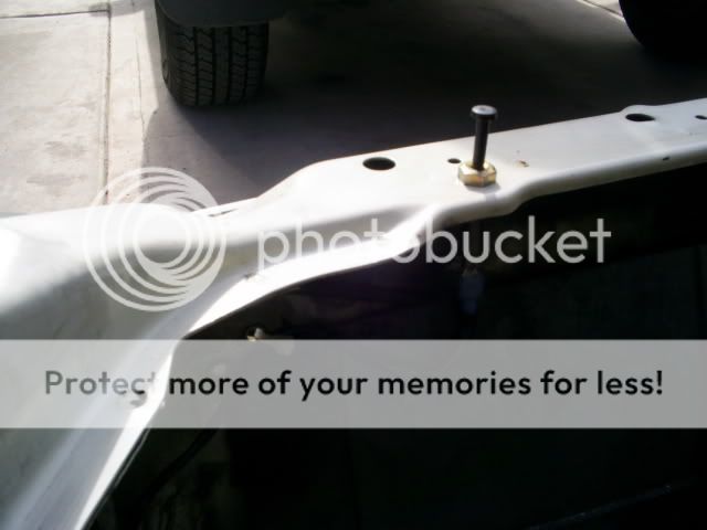

also install a hood pin, the more protection the better.

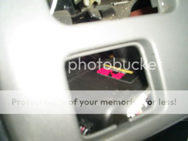

5.i started to assmble al the plugs into the alarm, like the led,valet,ect.
i use some tape so thiefs dont see any color wires or the alarm.
6. find a good place for the alarm,

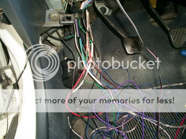

7. once u have the list of ur wirring and location start connecting ur wires..
here u will find all ur 12v,constant,ignition,starter,also the horn,parking light
this is a demostration of how i connected all my wires. u can do it any way u feel its safe.. i use tape because i will be removing this alarm later in the future.. this white plug with the blue/green wire is the horn.

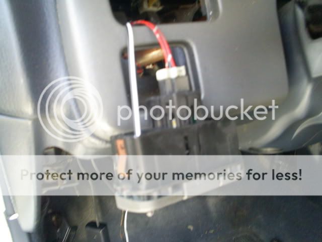

10. on ur left side,(kickpanel) u will find the wires for ur doors,domeligth,and trunk.. also this is were im going to be putting my relay for my locks.
