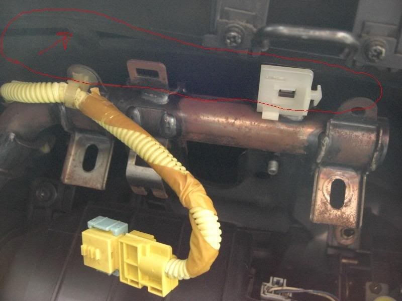

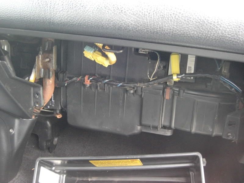

the problem is the glove box won't fit there's a bar on airbag side that isn't there w/ my 92. do i needa remove the air bag computer to have it fit or is that irrelevant?
- Fri Feb 26, 2010 11:29 pm
#178069
ok thats irrellevant take a pic of your dash if you could and try and get the problem areas i know wtheres like a plastic drop down that has cut out spaces in between where the p.side airbag would go if you will i just cut that out and discarded it and it fit perfectly if you post pics ill ms paint what you need to cut

that you need to cut out first or the dash wont sit correctly..... hopefully that helps
