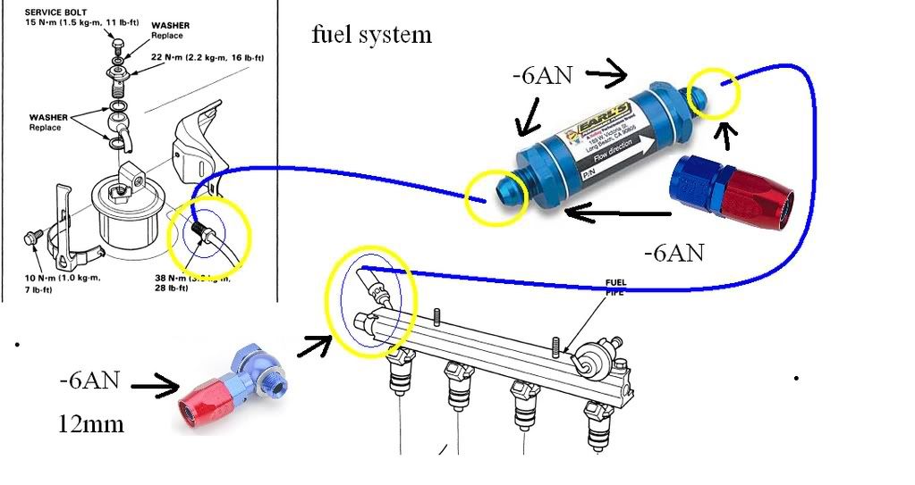

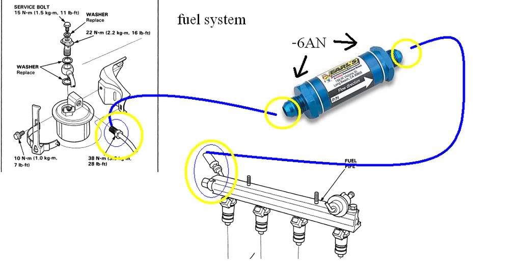

#30387 Ok i was just wondering how i could do this to best hide the fuel filter, and look good at the same time... so i am wanting some help, this is what i have so far hahaha:
The Earls filter is going inside the firewall, and i woudl like to have a AN fitting on the firewall where a steel braided line would go to my fuel rail...I just dont knwo what banjo nuts i need or the best place to buy them? Help!
thanks in advance!
P.S. I am new to the -an fitting world! -6an may even be to big.
#30389 haha ok well after a few min of searching i found some of my answers!
Now i just need to know what size the hard line is coming from the fuel pump, i know i need a hard line to an adapter...i think!
#30426 on my tuck, I cut the fuel line not too far after it enters the bay, then used a 37 degree flare tool and put an adaptor on it to convert it to -AN and ran it as a steel braided hose from there, to a small edelbrock inline filter, then a 90 bend right into the fuel rail .
I still have all my plans on paper some place with part #'s, I'll look for them
