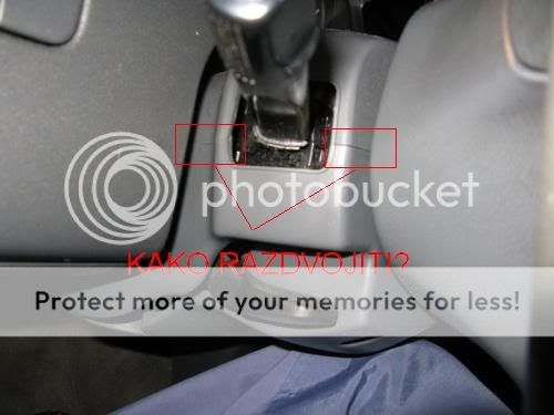

By kamikaza
#169242 how to split up this???
By d-mon
#169253 as stated before, probably your ingnition switch.
happened to me, it would shut off after cranking when returned to the 'run' postion. i could hold it just right and it would keep running but when i let go it would shut off.
as for the steering column cowl, just stick a screwdriver in there and pop it apart.
there are 3 phillips screws on the bottom that must be removed first.
By kamikaza
#169259 thanks man...i'm gonna do it tommorow
