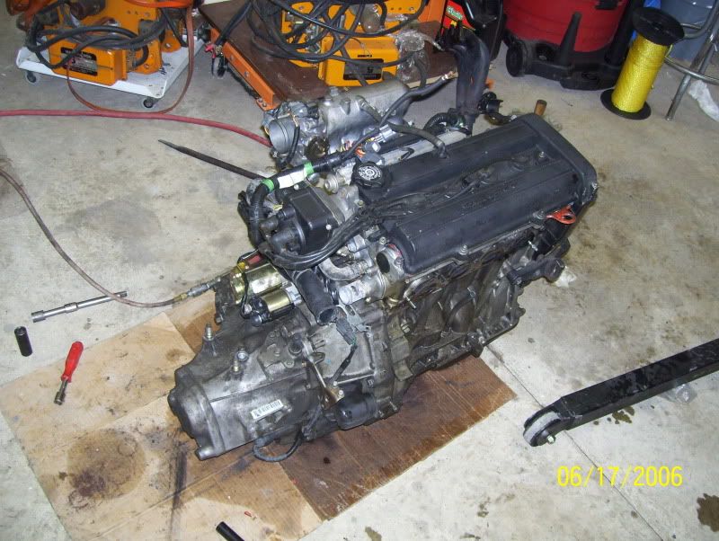

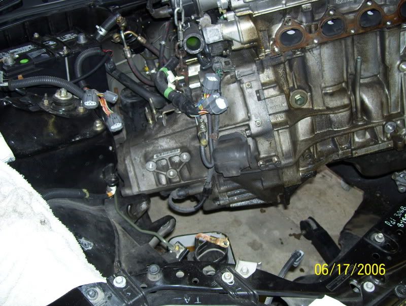

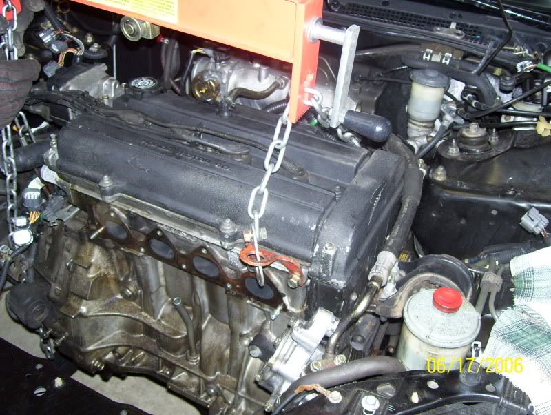

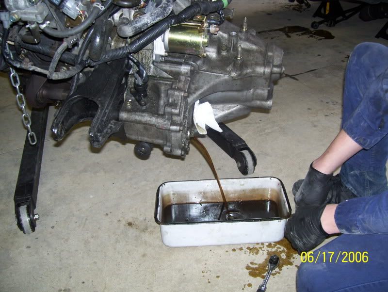

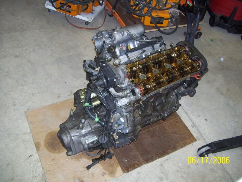

Warning, 40pics.

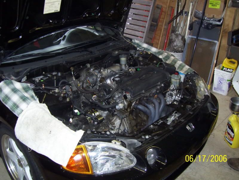

In my uncles shop
New oil pump that came with my B20 I didn't put in when I originally got my b20.
GSR Waterpump

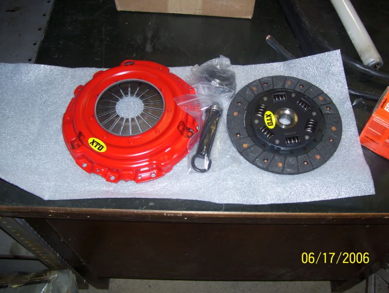

XTD Stage 2 Clutch kit

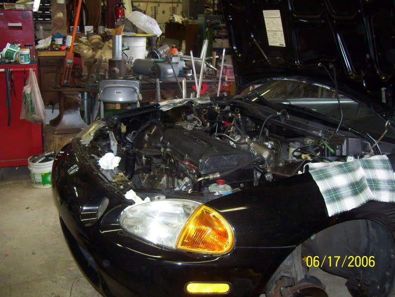

Preping to pull out

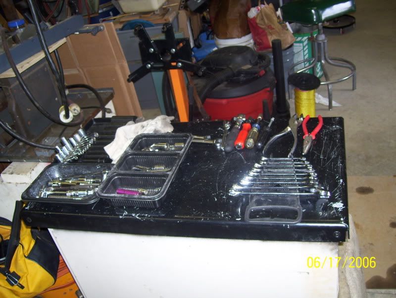

Organized tools FTW, ONLY way to work IMO.

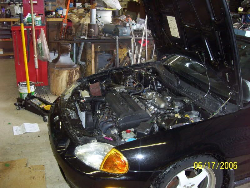

CAI,Radiator, etc taken off
Everything removed and ready to come out

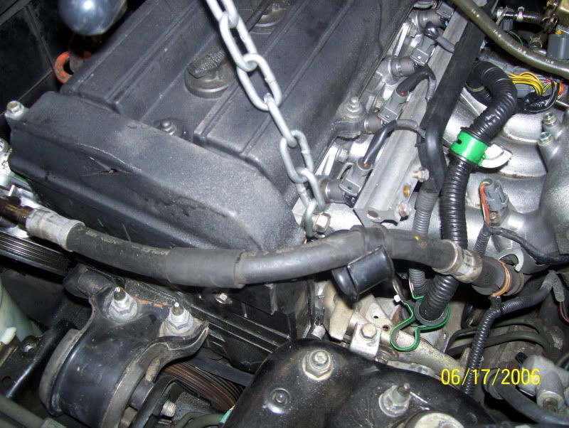

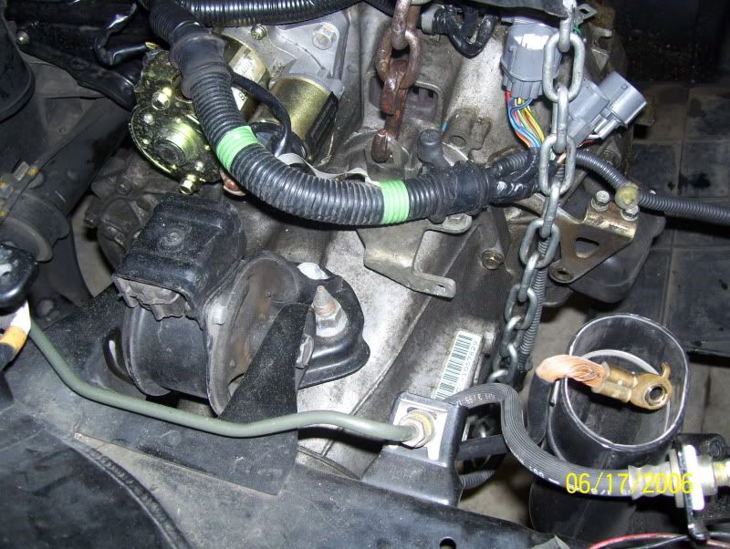

Chevy v8 Towhook in the power steering mount location
Bolt on the back of the head
Passenger side chain hookup.

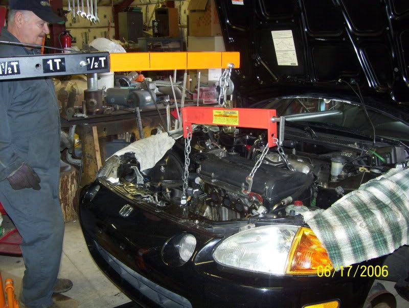

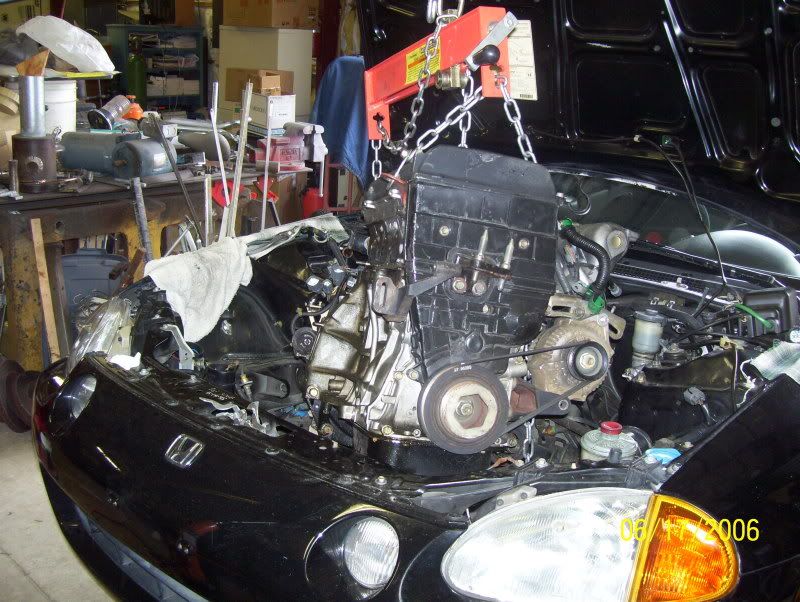

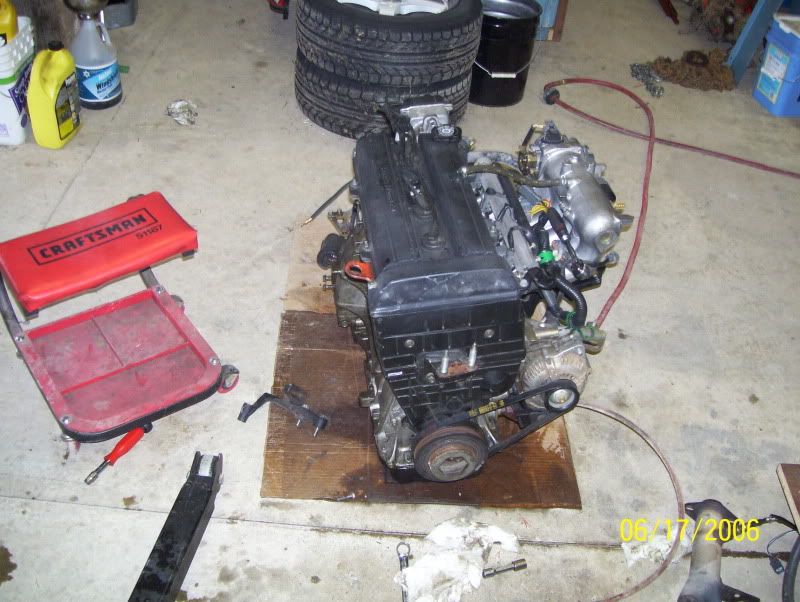

Out she comes
Need to come out at a 45' Angle
Draining Transmission Fluid. Refilled with Half snchromesh/10w-30

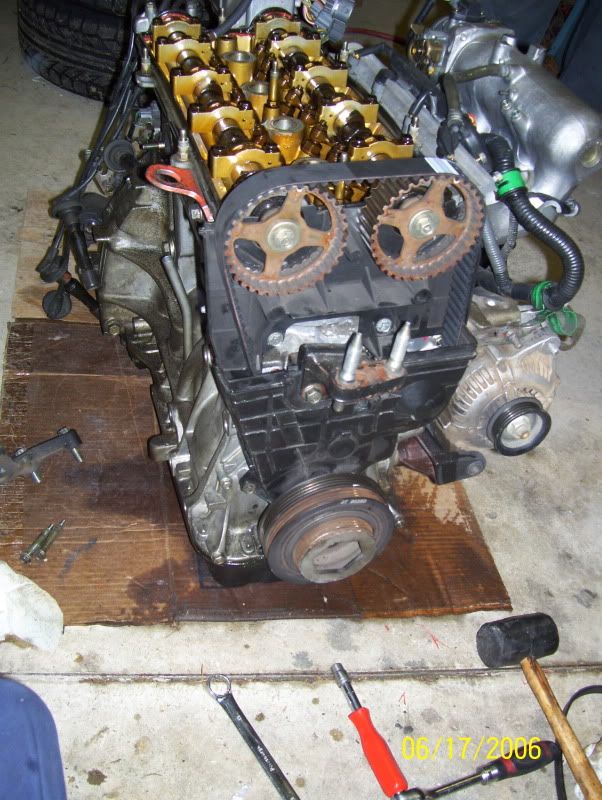

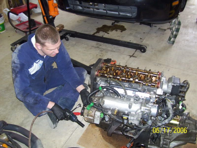

Pulled the Valve Cover getting ready for new oilpump/waterpump

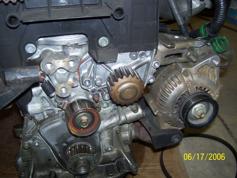

Removed side panel to see Honda oem ls timing belt, water pump and oil pump
me working on car

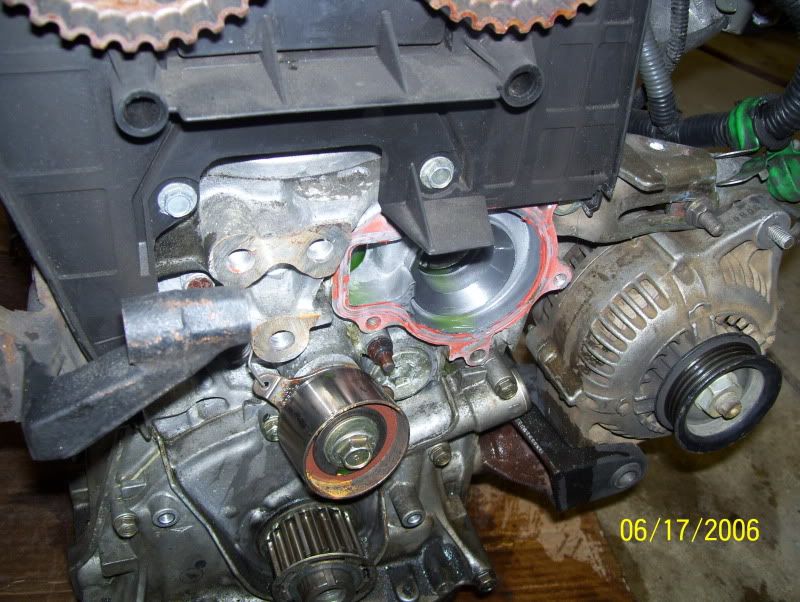

19T LS Waterpump
19T LS Waterpump Removed, Notice how wet everything is now? I didn't except there to still be coolant there.
22T GSR Waterpump Installed. got work happy and forgot to take pics.
Picture from up above, Cant really see it to well. my bad.
Full dressed up with 22T GSR Waterpump, GSR Timing belt and oem covers

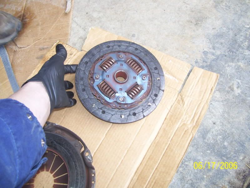

Old Clutch, notice that the rivets are warn

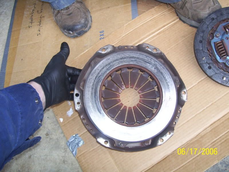

Old honda OEM Pressure plate, Notice the scarring from the old clutch, when I saw this i was glad I got the kit.
XTD Stage 2 Clutch and XTD "HD" Pressure Plate, Lighter to press down then the Honda OEM one. kinda disapointed in that.

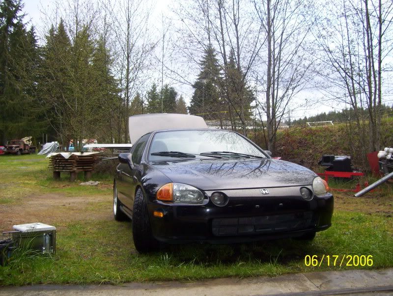

Installed in Delsol

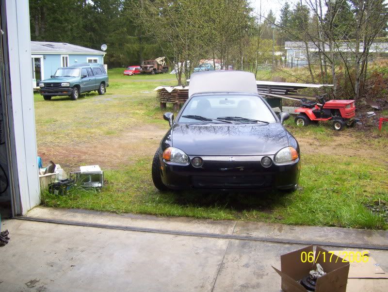

Delsol out of garage under own power.

In my uncles shop
Preping to pull out
Out she comes
me working on car
19T LS Waterpump

awesome work man.. if it were me, i would have left the engine in the car and just swore a hell of a lot more
pretty awesome how there is so much coolant left in the water pump eh? i have encountered that a few times..

Because you when spin higher Rpms with the engine, the water pump spins slower to reduce cavitation where the water "bubbles". Since he is planning on doing something with the head we will just have to see
