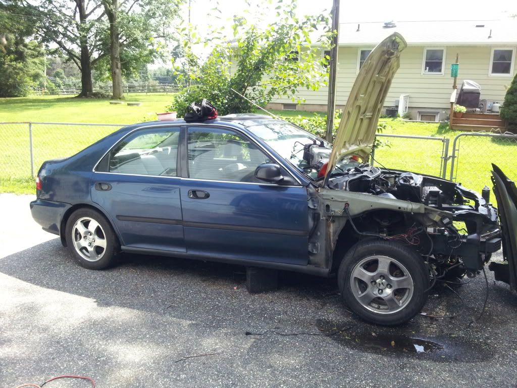

#335286 Black dash swapped (a while ago) I cant figure out where I want to mount my oil pressure gauge.

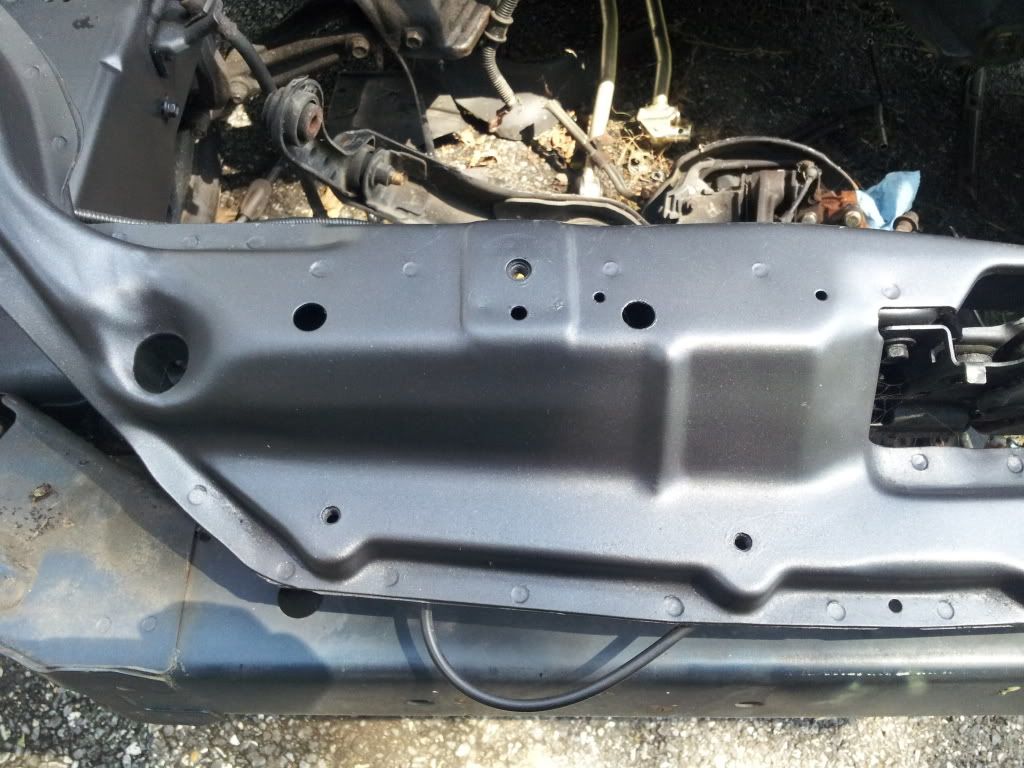

Pic before it rained, as you can see I still have not completed the passenger side wire tuck lol (got a bit more than pictured done but again it started to rain)

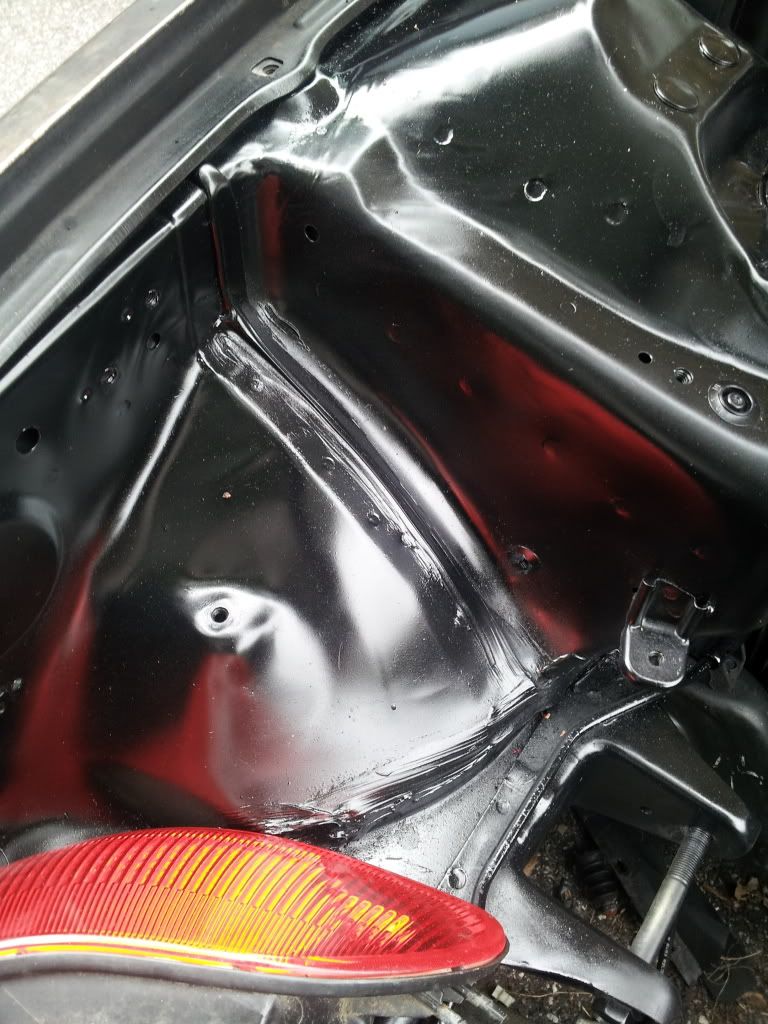

Just rattle can spray the bay (not cracks, they are spider webs lol)

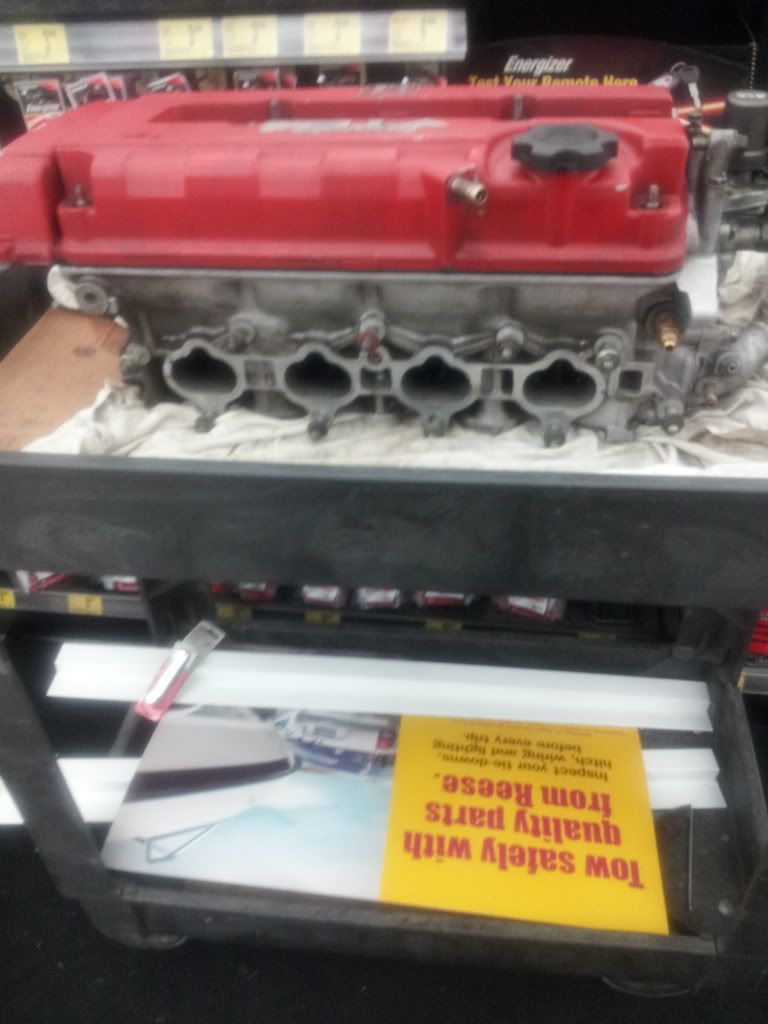

And last but not least a quick pic of my b16 head thats been sitting the back seat waiting for some parts :)

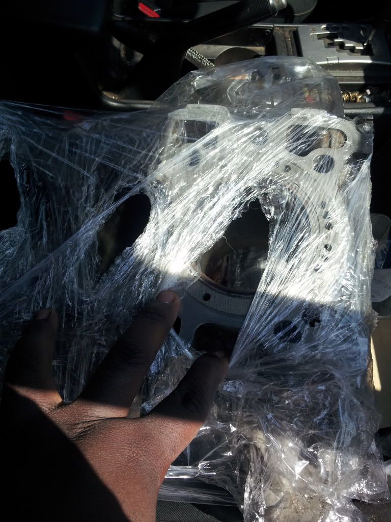

#335555 Forgot to post the css block. Snapped a quick pic before work, if anyone is interested in the css process done to their block, it MUST be decked as each one is done by the block that is sent in. Its not like the GE blockguard where its one size "fits" all.
They recommend you going with a larger radiator, I'm going to go ahead and either add more holes (two more to each cylinder) or just enlarge the holes already there to allow more coolant.

#335687 Quick update:
Realized that adding more holes in my css block would do no good since it wouldnt match the holes on the head :facepalm:. I'm still up in the air about what I want to do with it. Either leave it alone or just enlarge the holes just a tad.

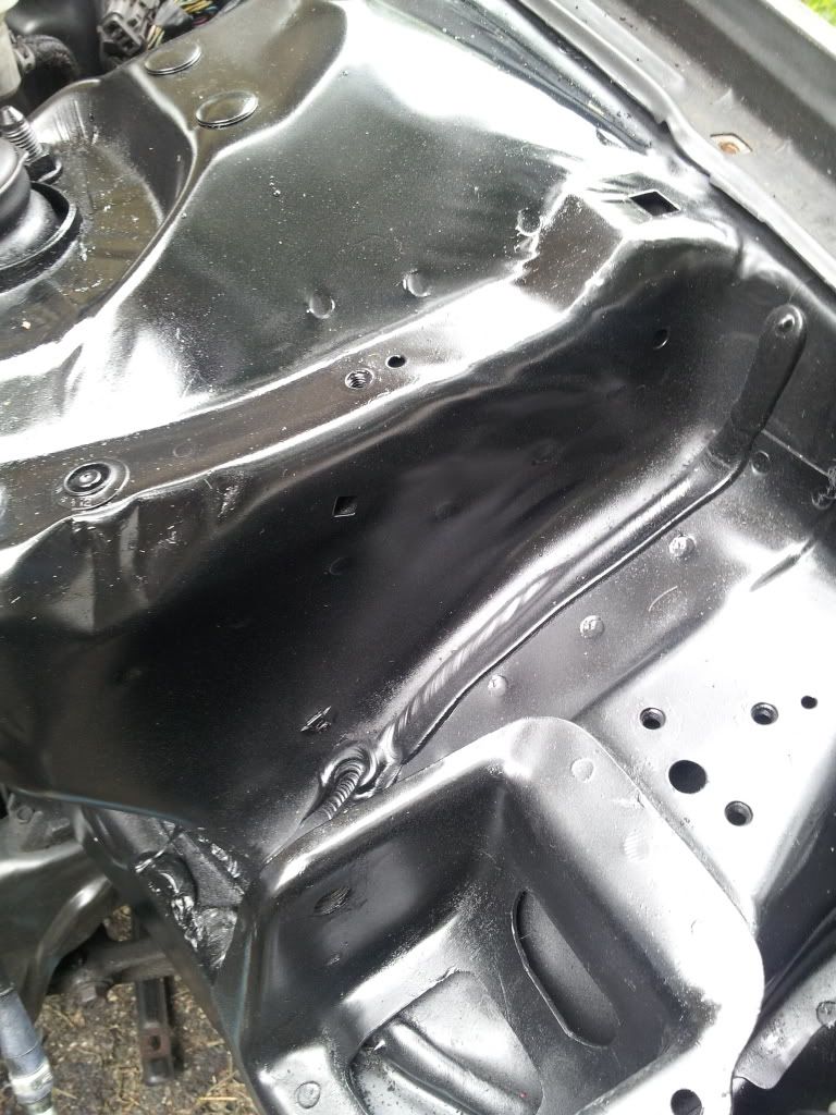

#335953 Decided to respray the bay black (probably regret it later). Also picked up a spare gsr block for $100 :thumb:

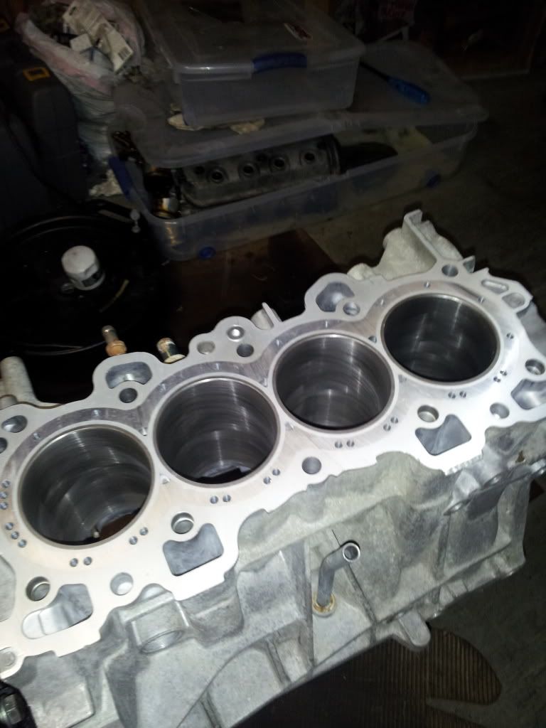

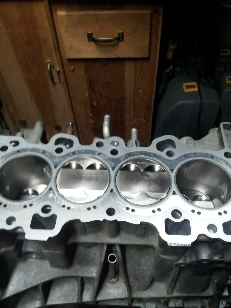

#337121 So 13 days I'm finally ready to start assembling the block :thumb: :thumb: :thumb: . As per usual I couldn't get started till late (10pm). I was busy doing everything and now that we are short handed at work I might have to go back to working 6 days a week :x :x .
Anyway I managed to get SOMETHING going today tho. I only managed to snap this pic before getting started, I'll pick it back up Sunday and snap a few more pics and hopefully have the block ready that day or late tuesday :).

#337157 Never just guess -__-. A very careless mistake is costing me more time. I have to take everything back out......
By Uknterror
#337193 All back together :)

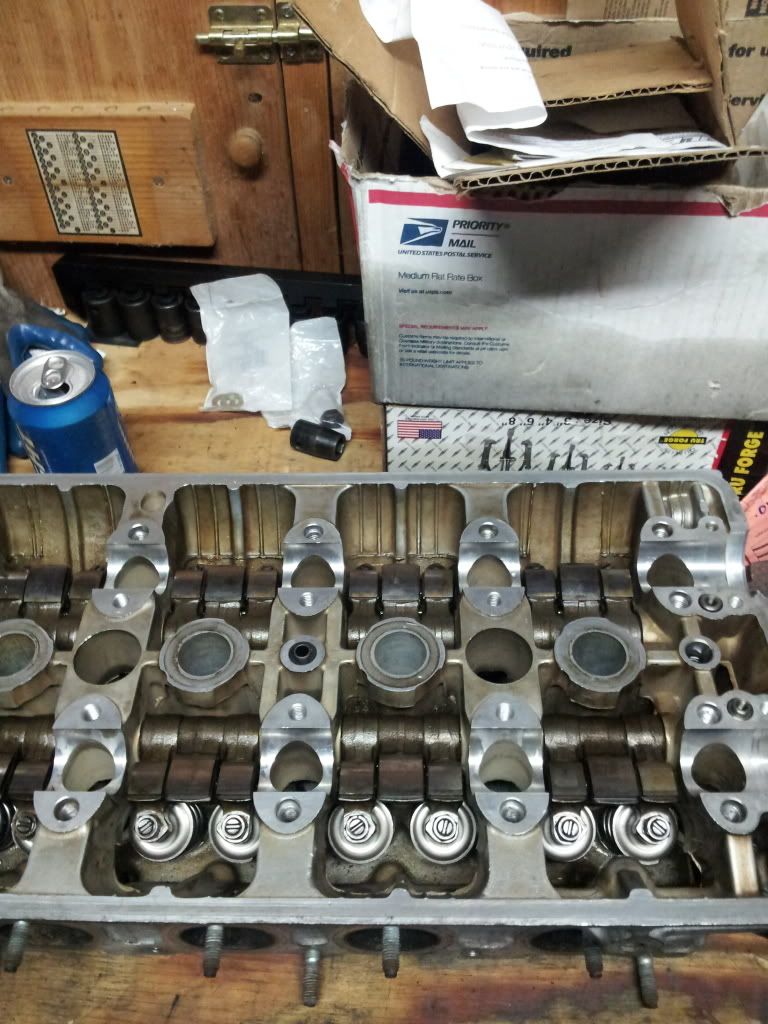

#337619 Ditching the oil cooler (I don't have the water pipe anyway) for now at least. I'll probably configure an aftermarket one later down the road. Anyway, head is assembled, doing some research turns out I don't have to spend as much to achieve my goal also my power goal has also dropped to 450-460. Picked up some 1600cc injectors on the cheap that have already been flow benched. I had originally planned on going with either skunk 2 pro'1 or tuner 2 camshafts but I can easily make my goal on stock gsr's $40 vs $600 lol
Skunk 2 lma's, supertech valvesprings, valve stem seals, and inline 4 snapfit retainers installed! Getting pretty close!
