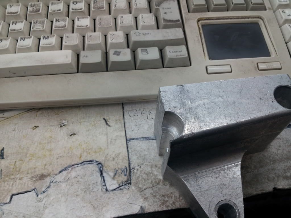

#325076 Finally started to get the motor ready for conversion, started to grind down the block to clear the midshaft. Gonna clean the outside and paint block a solid grey (i know boring), my sychros SHOULD be here sometime either tomorrow or tuesday, when they come in ill be getting the trans rebuilt.
Depending on how much I can get done in the next two days I MIGHT (lofty goal) be able have the block and trans mounted in the car, after that the head will be sent off to get some mild work done. Will I have it ready by the end of march? who knows, stay tuned!
Side note: QSD's instructions are laughably horrible, the pictures are way too small and could the whole guide could re use a redoing. I'm still working on my abs guide, but I really want too do a QSD h2b guide as well.

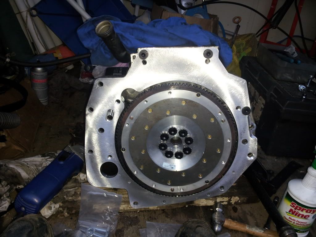

#325213 New Honda Oil pump installed, started working on h2b conversion. These instructions are freaking aweful! lol

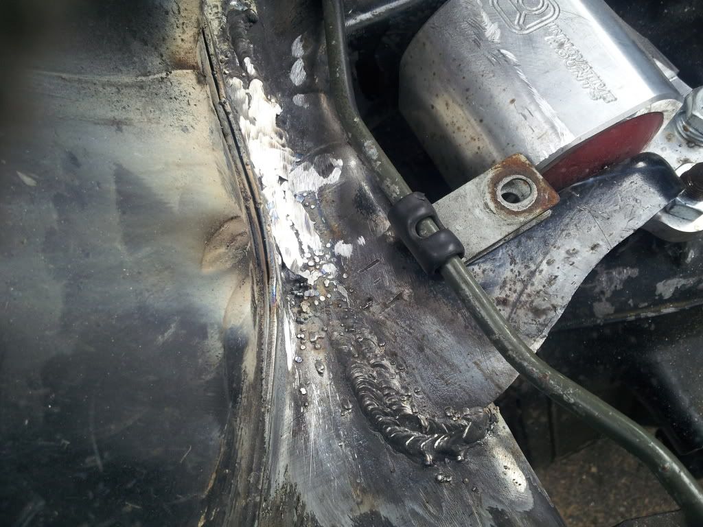

"Modified" to clear timing belt
Traded my hx's for polished gsr fat fives
Fully rebuilt gsr trans with carbon synchros attached and trans bracket hard welded to frame with new oem bracket

Starting too run into some more snags, long story short the crank pulley hits the frame, so now I have to drop it back down and smash the crap outta the frame (not much really).
Ive got the timing set and head back on, still have a good size list but should be able too get most if not everything knocked out in the next few days!
