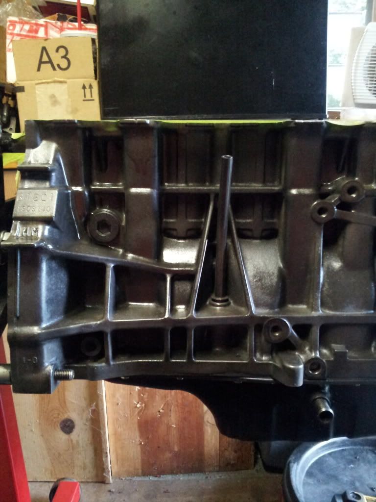

#337794 Block 85% complete :)

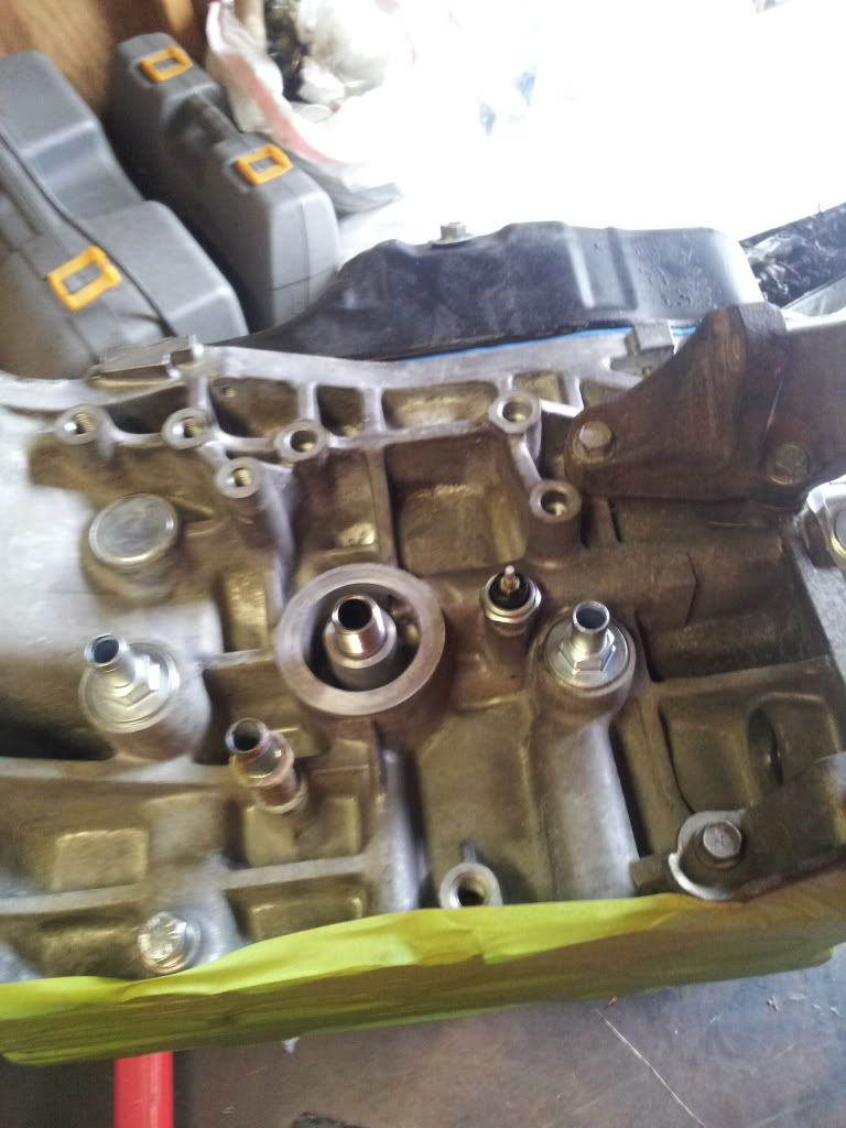

#337934 Block plugged and prelude oil cooler fittings are on, waiting for catch can..........or just dump that shit to the ground lol

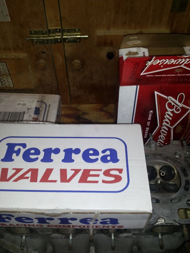

#338887 My Ferrea flat face valves came in today! :thumb:. Coworker did a little a research (for his car) on these and got a response for inline 4. They say for a mild n/a track car they actually recommend the dished 6000 series valves mainly because or how much more lighter they are. You will see more of a gain from lighter valves than a heavier valve that that increases compression. Now my car is turbo I would probably also benefit from the 6000 series as well, but I'm poor and can't afford the cost difference :lol: so these will be fine.
Also had to buy a new set of diff bolts (as the a few of the ones taken out got stretched when taken out) that set me back a little. Also the hood on the car was being borrowed and now needed to be taken off because it was sold. So I had to buy another hood (set me back some more) ugh talk about poor timing haha. Well atleast the list is getting shorter!

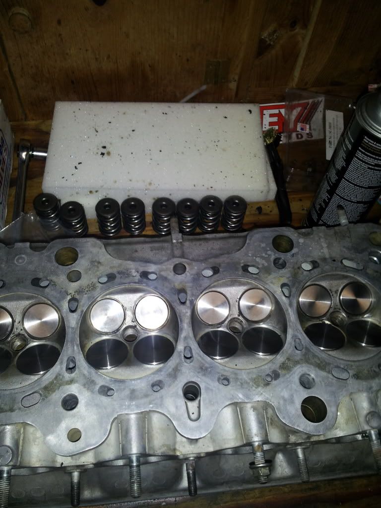

#338958 Installing valves
Valves lapped and installed :thumb:

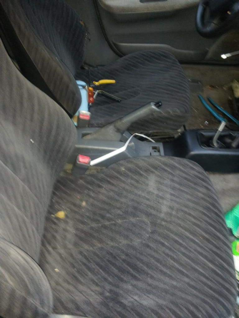

#338982 No engine parts, thats fine I got other things to do :)
Del Sol Si seats installed :)
