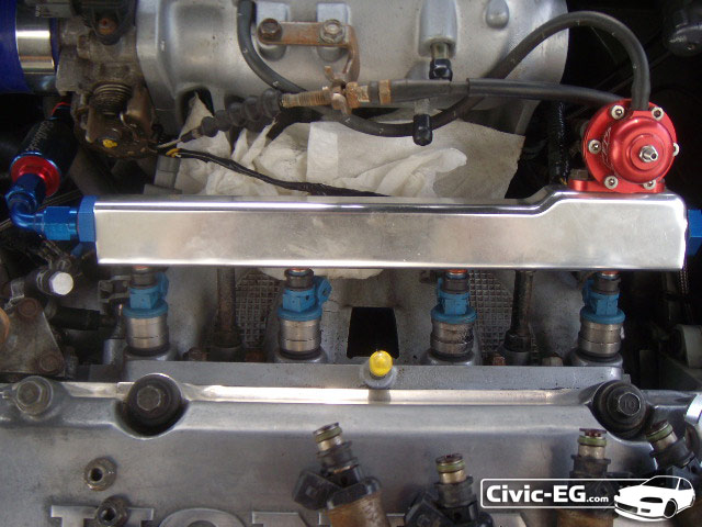

Fuel Injectors
I used the common Blue Top DSM 450cc's and a resistor box. They already fit the OBD1 harness.
Relieve the fuel pressure and have some rags handy.
Remove the rail
Modify the donut gaskets to fit
If you are using DSM 450cc's - also remember to install a Resistor Box.
Here's a way to install one without cutting any of your factory wires: http://civic-eg.com/viewtopic.php?t=10140
They were a tight fit, a little lube was needed to squeeze the tips in the rail.
I ended up lightly sanding the gasket to reduce the outer diameter to make them fit in the rail.
Note that i have a fuel pressure and fuel gauge installed - very helpful when tuning.

Fuel Injectors
Remove the rail
