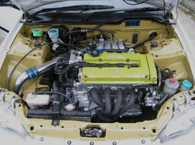

i have done it in my civic and my truk now. its actually easy mount the battery in the trunk. (or wherever you want)
get some 4gauge stereo power wire and run it from the + trerminal to your starter, use a lug connector and connect it to the 12mm on the starter
next run a 8gauge stero power wire from the + terminal to the fuse box
if you relocated the fuse box then you will also need to run 8gauge steroe power wire from the fuse box to the alternator the same way.
last grind a spot in the trunk to bare metal and run a 4gauge power wire from the - terminal to bare metal spot and bolt it down
