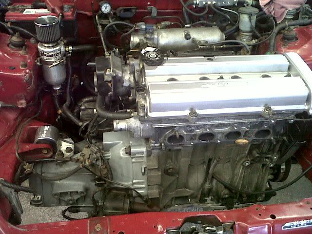

got everything but the header un-bolted/screwed/clamped. motor will be out tomorrow and I should have the other one in by the end of the week!
the only thing that worries me about the JDM motors is.. it has been a good 10+ years since its ran. keep your fingers crossed for me fellas, lets hope she fires right up!!!!

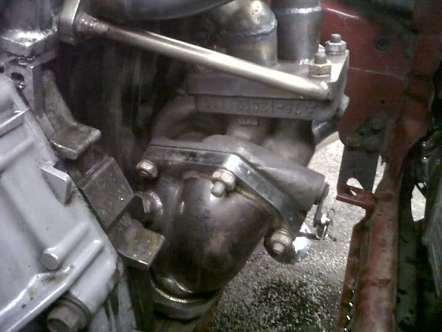

because of how close the Evo O2 housing is to the block, the manifold/turbo/downpipe have to all come out as one piece..
worlds longest civic downpipe

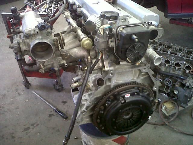

Today's updates...
the old girl all stripped down..
JDM B18b now has the.. Intake mani, alternator, freeze plug adapters, oil plate and clutch/flywheel. Also did Timing belt/water pump and a new thermostat. All that's left is the dizzy. waiting to put the oil pan on till the motor is in
