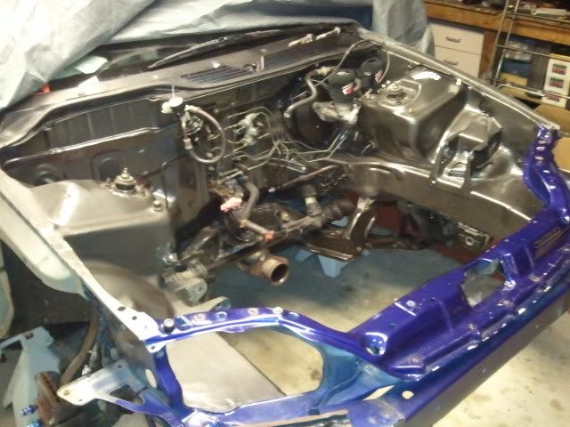

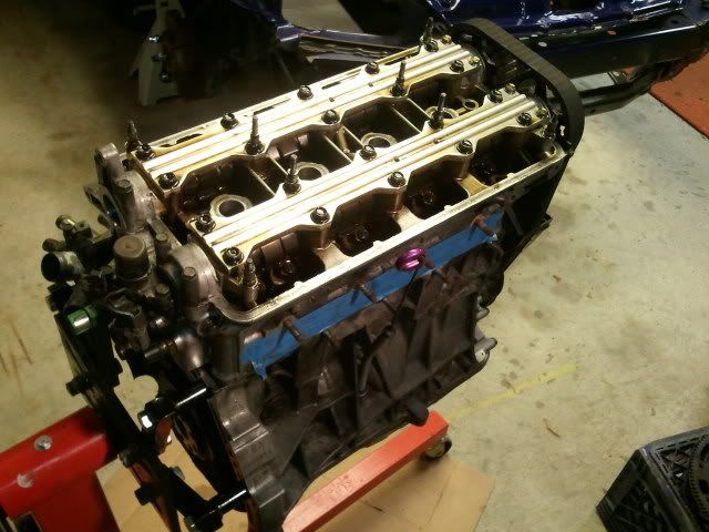

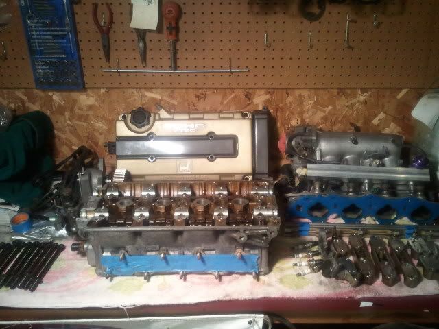

#279121 tuesday nite me and a buddy started tearing down the motor.
now to check out the block

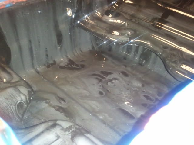

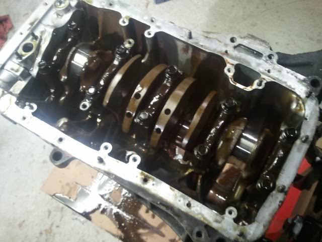

the oil pan.... look at her sparkle lol

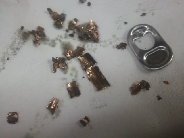

and look what we found in the oil pickup! ... some valve seal shavings... this explains why i had low oil pressure and no vtec.
(can tab is for size comparison)

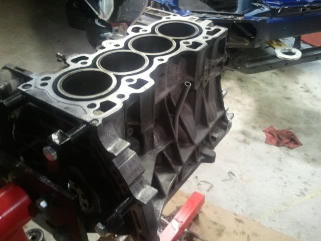

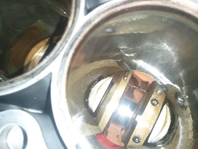

walls dont look too bad

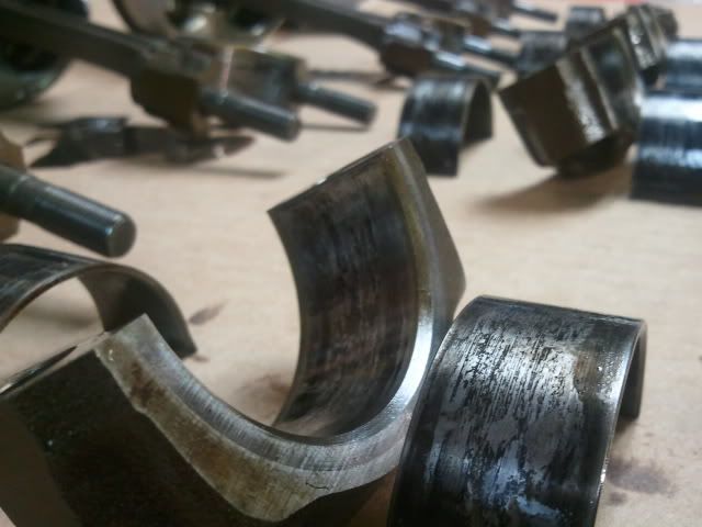

i forgot to take a pic of the other side of the bearings, ill try and get one today
no turning back now!

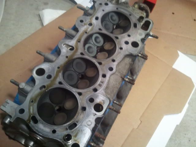

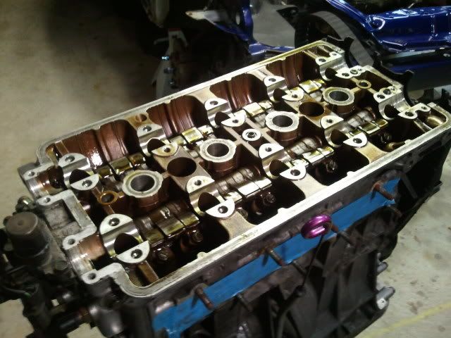

#279731 UPDATE
so after finding that my head is clearly clapped, the new plan is to continue with the plan to boost, but my priority is now to fix the head first. Not sure if i want to just go with stock internals for the head or something like a supertech valvetrain upgrade. or maybe ctr valvetrain. Still planning to get everything else just putting the possibility of the weisco pistons and eagle rods on the backburner til the head situation is figured out

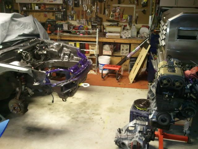

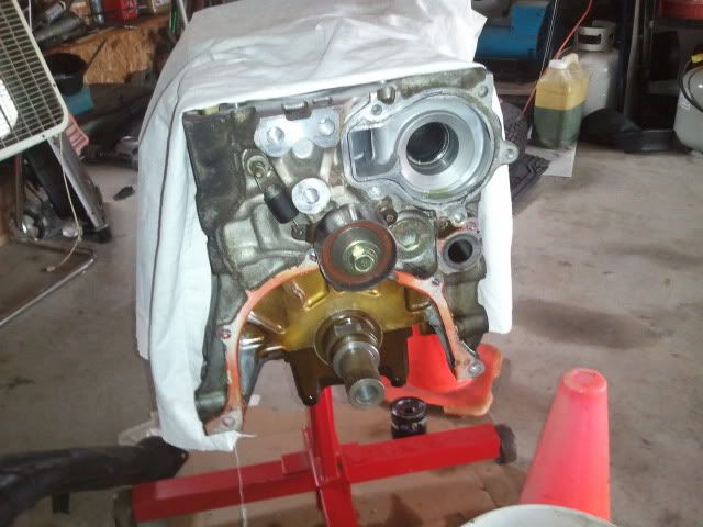

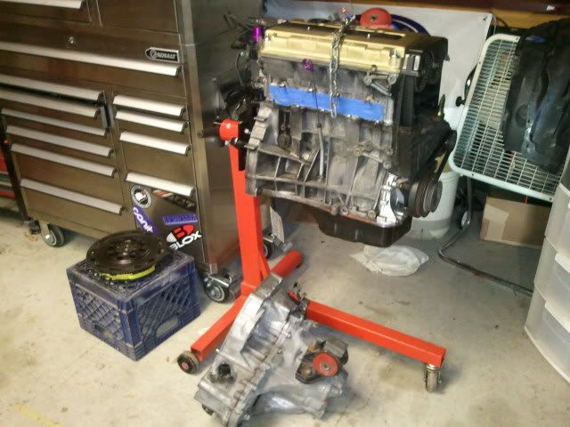

i got everything pretty organized and also got the oil pump and water pump off yesterday

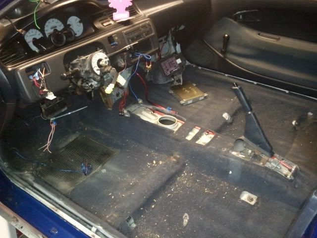

i also continued to tear apart the interior.

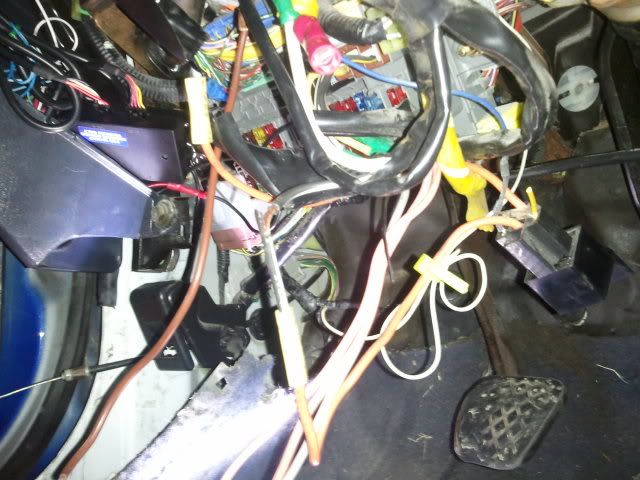

and wehn i got the car it had an alarm that didnt work so i tore as much out as i could but heres the cluster fuck that was left.
ill post up pics of all this nonsense fixed, also i have 4 gauges to be wired in, and my boost gauge once i order it. So i want all the wiring to be as clean as possible
