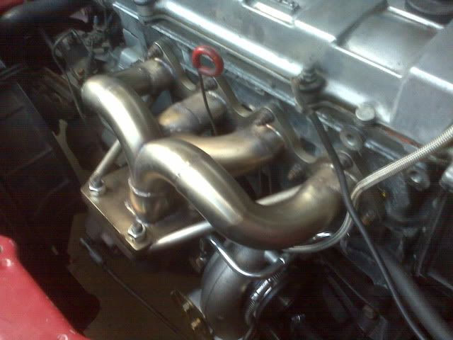

nice progress man
I know the feeling when you're getting so close to being done with a turbo build!
I can't tell in the pic, but be sure your return line has a nice angle so that gravity will carry the oil down to the pan. Be sure there's more than enough of a slope if you're working on a flat surface because what if you're at a stop light or stopped facing down a hill with your motor running. You don't want that return oil to get backed up and not flow enough... that will blow the seal in your turbo.
I'm paranoid of this because I only put just enough of a slope on my line... so I shut the car off if I'm stuck facing down a hill for more than 30 seconds.
