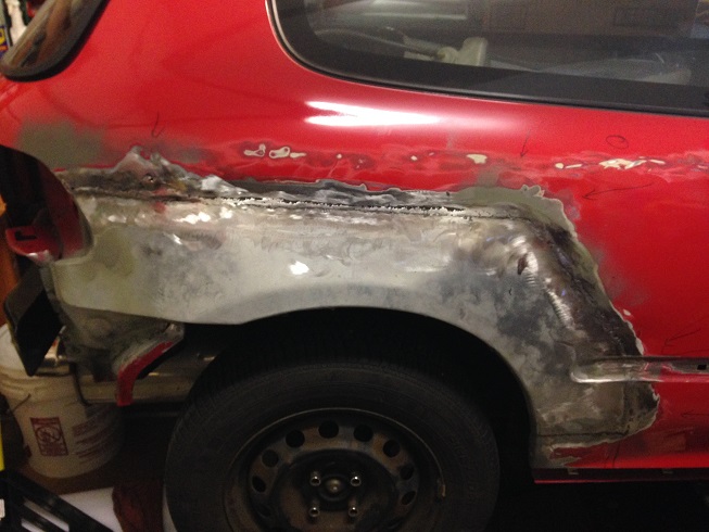

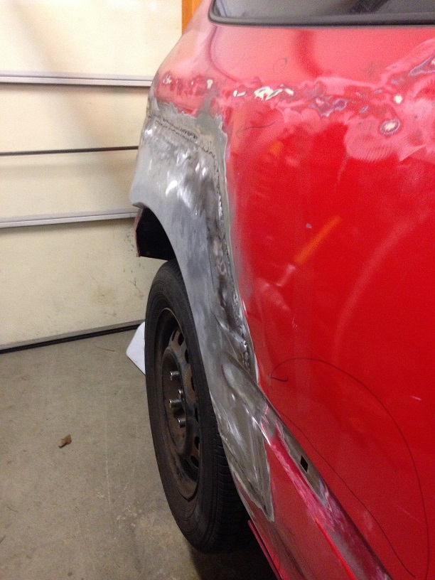

i tried welding the fixmyrust panels and caused it to warp. how would you guys fix this? cut it out and completely redo the welding and grinding with a new panel or try to blend the warped parts with fiberglass filler?
[attachment=0]resize2.jpg[/attachment]
[attachment=1]resize1.jpg[/attachment]

flamingdragon wrote:i tried welding the fixmyrust panels and caused it to warp. how would you guys fix this? cut it out and completely redo the welding and grinding with a new panel or try to blend the warped parts with fiberglass filler?
That sucks, but I wouldn't do it all over. I'd go with some quality filler. Give it plenty of time to cure/shrink before going on to paint. Mine warped a little but not that bad. It's easy to get on a roll when welding and get the metal too hot. A lot of breaks is key, alternate from side to side will give time to cool too. :thumb:

Would you recommend reshaping the panel with like a dolly or a porta-power? My dad said he was able to push out some dents on my cousins fender that got banged up hitting a deer with one.

You could try it, but I think an area warped from welding will be harder to press out than a dented area. Keep an eye on the welds to be sure they don't crack. :thumb:
